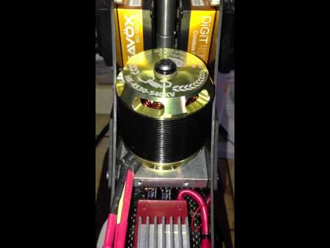

    I've put the Scorpion 4530/540 in my TDR and set KSA mode, now I get extra tones after the cell count.
    Is it normal as a warning KSA is active or is something wrong, the motor spins up ok but not had it out for a fly till I know what's going on.

    Only time I hear that telephone sound Paul is during set up so I'm sure something is wrong , have you refitted the link ?

      Yeah i have the Jlog2 fitted and that's working as it should.
      Maybe i should do a reset to mode 1 then back to 4 and 9.
      But the LED is on and not blinking, Strange....
      Paul.

        Don't treat it as some definite advice but KSA mode is not really needed for this motor. Only use KSA if you have cutoffs.
        That sounds is not right, it's error sound.
