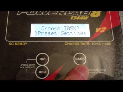

    Just been charging up for tomorrow and couldn't work out why my packs wouldn't go past 90% charge. Was charging 4 6s packs on high power so I tried a single pack on accurate charge and again wouldn't go past 90%.
    I tried a fresh cycle with the packs on 90% on parallel and single packs and it wouldn't put any more juice into them. Thought my packs were faulty.
    After much head scratching and tinkering I connected the PL8 to the laptop to see it had detected cold weather and went to reduced voltage mode.
    Is there a way that this can be over rided or have I got to move to a warmer part of the house to charge?
    Thanks

    Turn it off
    Simples
      Turn what off Nick? Do you mean cold weather detection? If so how?

        Yes,in each preset you can go to 'properties' then 'cold weather T' and select NONE.
          In the settings you can reduce it to 5 degrees beign the lowest I think, no you can turn it off
            Thanks chaps. Now I'm off to put the remaining 10% into all my packs

                      An easy trick to stop it is to discharge a pack for 5 mins. Stop it and turn the charger off and back on and it will no longer be in cold weather mode as the charger will be warm.
