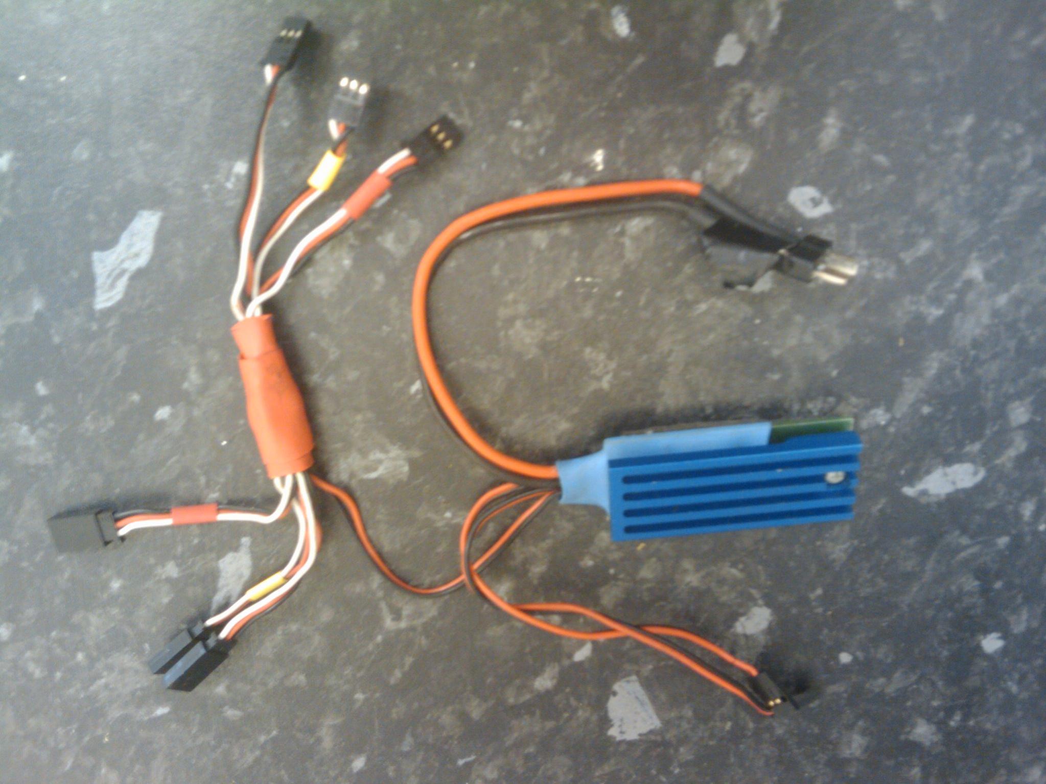

I hate not having an answer to why stuff happens so bear with this longish post.
The crash was a simple flip to inverted and then heli plummetted to the ground on it's head. I can find nothing on the carcase to explain that and the only two things that make sense to me are that:
a) I gave the wrong input despite remaining convinced that I didn't..
b) I gave the correct input but didn't get a response. Usually with glitches and brownouts and all the usual excuses one would expect some sort of erratic behaviour or a failsafe response.
Lets go back a year (said it was longish)..
I had a predator gasser that decided to go walkies on it's own. I was happily flying a simple circuit and at the end of a long run it refused to turn on rudder and kept straight. I banked and it kept straight banked. Ineplicably it decided to turn itself 180 befre going out of sight and came back. I toggled throttle cut and my remte earthing killswitch with no response until heli has flown past me 100yds when it finally decided to cut it;s engine and piro down an auto. At the time i flet that it had to be an onboard power issue on such a heavy bird with it's servos etc and even though i found no sign of power problems I ended up modding it to totally dual systems etc.
It used to have an align reg before which despite my extensive bench testing never showed a problem.
Of course after a year in my parts boxes THAT is the regulator I shoved on the Blitz since the onboard glow is handy.
[B]SO [/B]If it was capable of a transitory power issue that allowed heli to fly straight before could it have been responsible for another freak situation where a power drop held cyclic but collapsed collective immediately after the power usage of a flip??? Power drop would also bock failsafe throttle cut..and even if it didn't there is a 3 sec delay..it hit the ground before 3 secs..
Either way it's going in the bin unless someone wants a free align reg?
(and I fully accept that one would normally expect power failures to give some erratic effect but this is on futaba 2.4)
