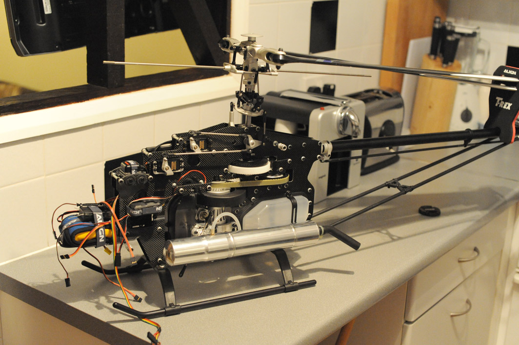

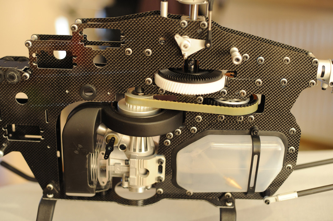

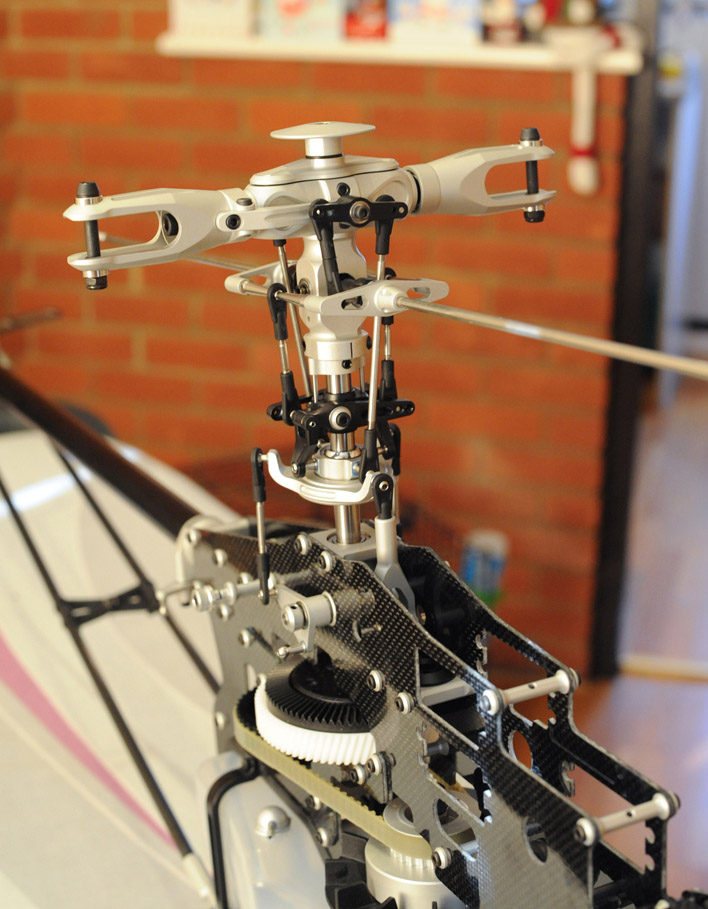

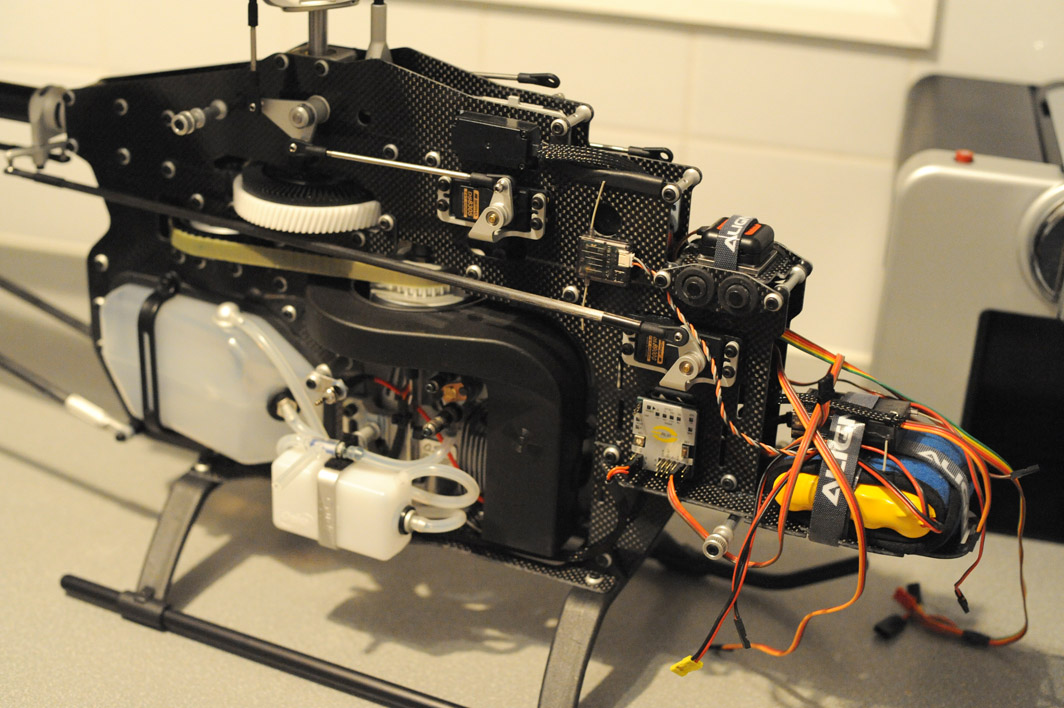

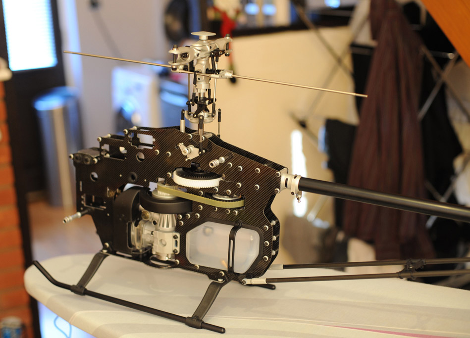

Some snap shots of the build so far. Build has been excellent. Everything bagged properly, hardware is High Tensile steel, so haven't stripped any socket heads.
The only thing i am a bit nervous about is the push rods for the tail. I am used to having a solid link between servo and tail, but this has carbon rods with 80mm studding each end, the studding is glued in place with epoxy, with 9mm poking out. The links are then screwed on. Would have thought solid piece of studding would be better. Just hope the epoxy doesn't fail!
-James

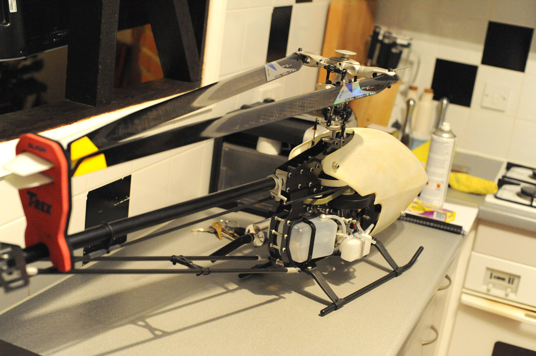

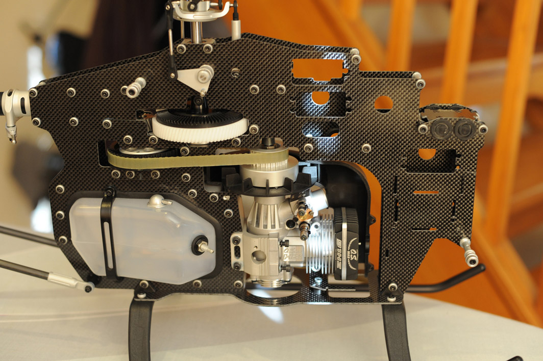

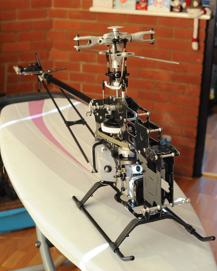

Well, its almost built!
Now awaiting Throttle servo and Paddles and a the canopy needs painting (probably gonna send away to get done)
Spec so far -
OS. 91 HZ Engine
Spartan Gyro
JR 8900G Tail Servo
JR 8305 Cyclic Servos
JR 8231 Throttle Servo
Duralite Regulator setup
Hatori SB-20 FB Pipe
Quick UK Header Tank
CSM Revlock 30
Scott Gray 710mm Rotor TechBlades
Rotor Tech Tail Blades 105mm
Hopefully be done in time for the warmer weather!Last edited by KnifeEdge; 03-01-2009, 08:57 PM.James
