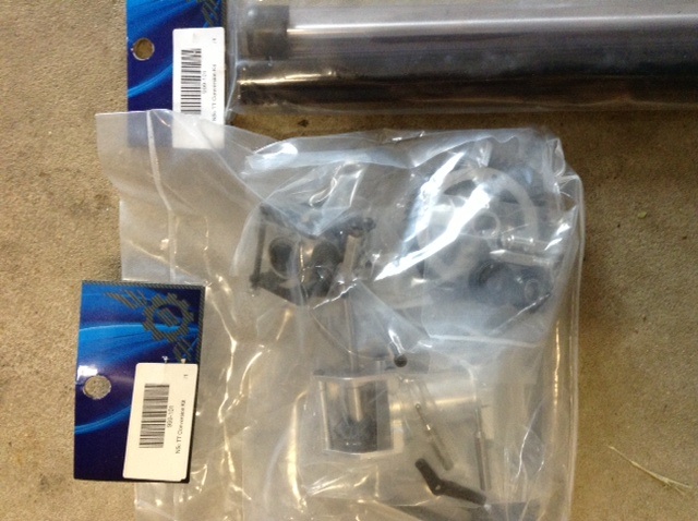

                      Managed to get a bit of free time today to install the TT conversion. Packaging is good, online instructions clear. Basically remove the back end, pulley and counter gear. Dry mount TT CF plates clamp up and drill 4 3mm holes (remove from umbrella gear and mount before you drill). Now reassemble sytematcally with loctite. Loctite counter gear and reinstall head with new gear.
                      Tail gearbox give options to pin, I chose to do this. I mounted the gearbox fully put a guide hole in but later it was a fraction out as the tail gearbox in my case didn't seat quite as far back. No problem I fractionally 1/2mm backed boom from front. If doing again I would mount everything first then pin the boom.
                      Remove tail grips and slider, mount these and flip grips. Easy enough blades rotate clockwise so nice Rail motif faces the boom now. Adjust pushrod easy with new ends and your about done.
                      Check FBL end points and direction and go fly :-)
                      Seems very smooth and well thought out.
                      Get all your glueing done first like TT bearings and an end of pushrod then do the switch. Just saves time and glue gets good time to cure.
                      Overall I like it, no more typing off to fly it.
                      No idea what's going in with the pic!!!
