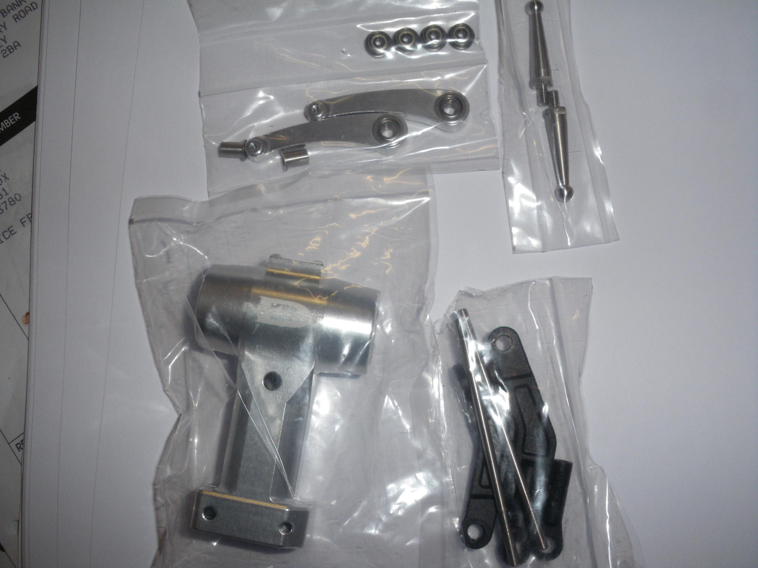

      Hi everone just a mini update
      As promissed the Flybarless conversion kit arrived this morning from Mark christy
      It just looks sooooooooooo nice so clean and uncluttered
      I must say a HUGE THANK YOU to Mark for providing these parts FREE yes FREE , I am so humbled by his kind action
      I only hope I can give back to the fantastic model heli hobby even half of the time & now parts that others have done.
      HUGS Mark & ALL !!!!!!!!!!!!
      oh a picture just to make Pete green with envy !!!! don't worrk pete your Aura will come one day.

        Originally posted by rachel View Post
        I must say a HUGE THANK YOU to Mark for providing these parts FREE yes FREE.
        Does Mark do free heli's? lol.. lucky you.. cant wait for photos of the finished product!!

          In the reply they sent you Rachel, I really like the way they explain the reason behind use of material in the helicopter , you can get a better understanding how the machine was born from a engineers mind.
          Keep the pictures coming, it a interesting thread.

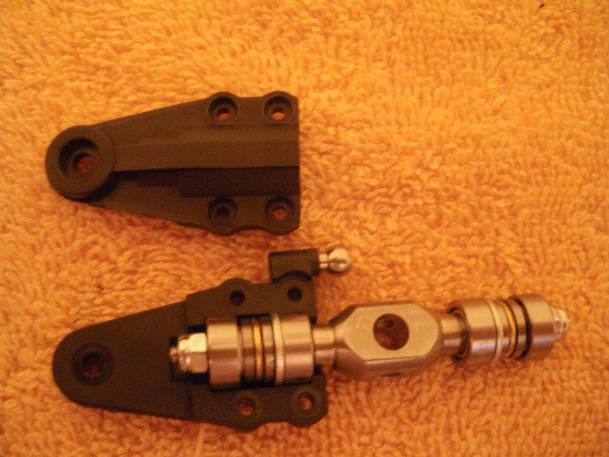

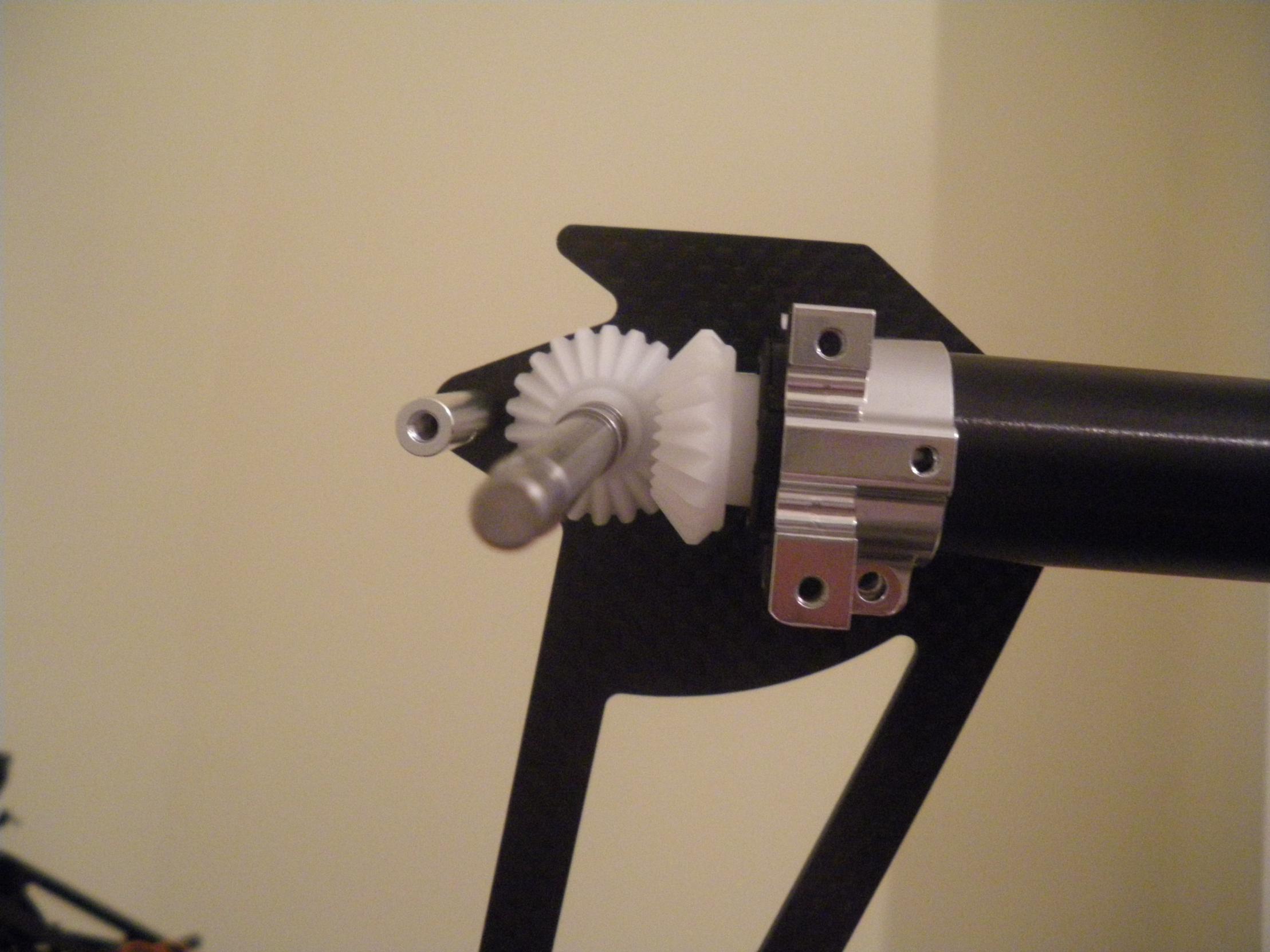

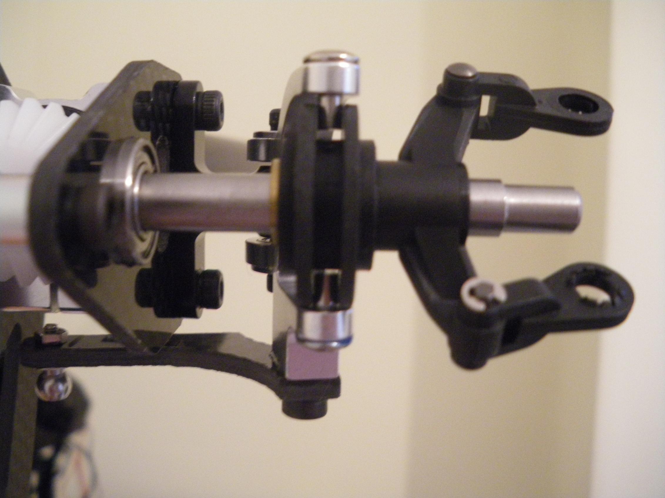

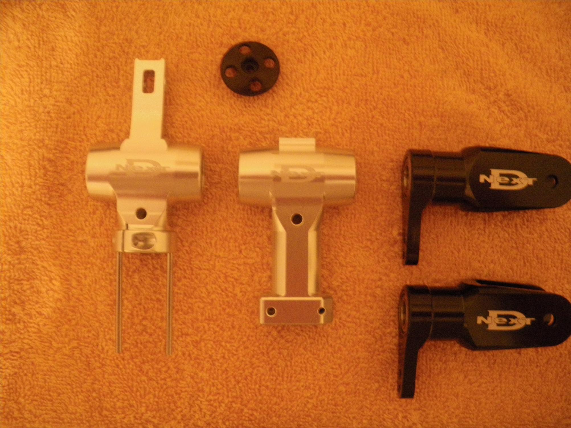

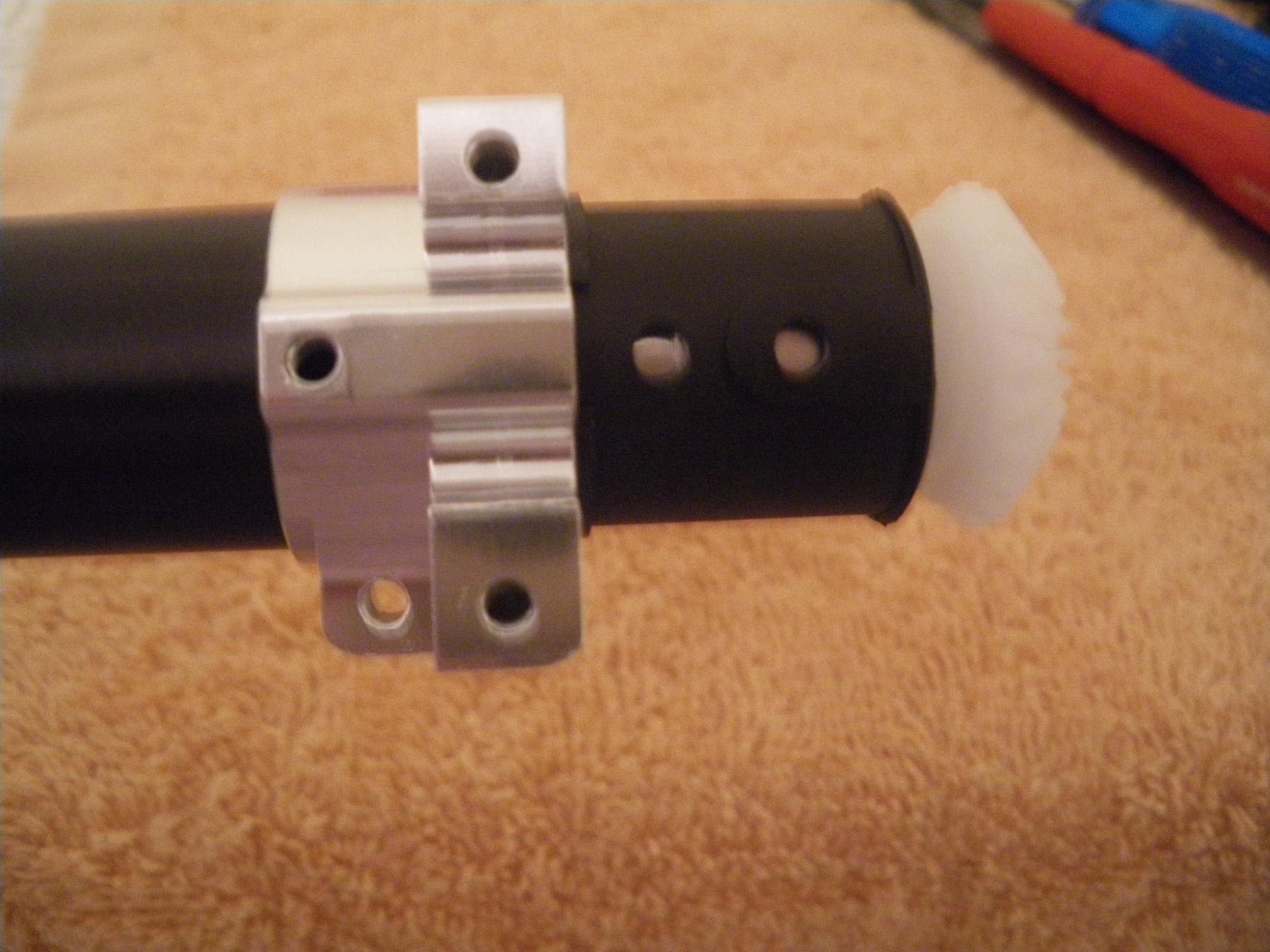

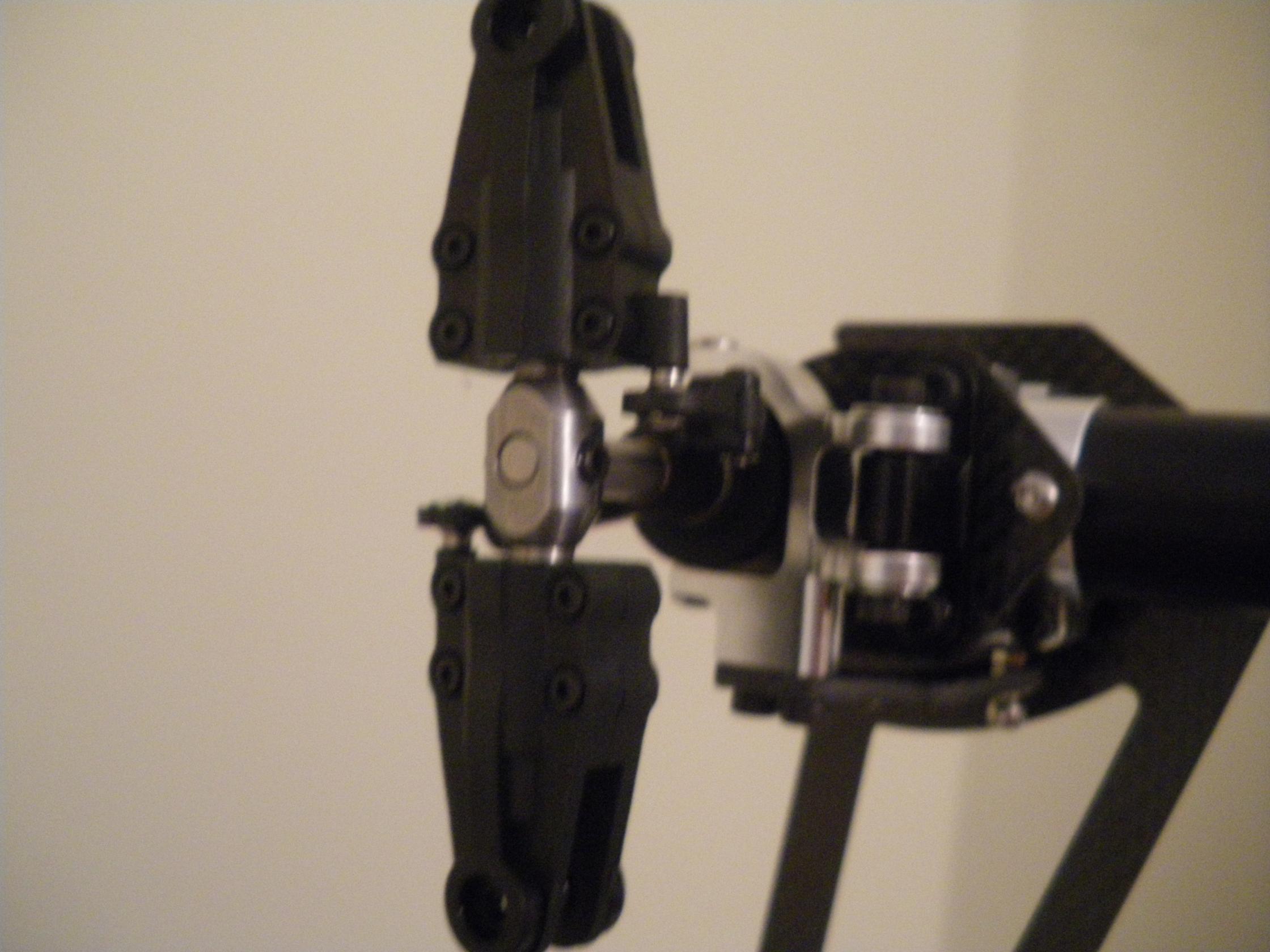

                        Ok sorry for the lack of an update yesterday i am afraid life just got in the way
                        so whats been going on well I started the rotorhead and stopped dead ,.. why,... because the flybarless one looked sooooooo smooth and uncluttered , now several people have given me the sound advice of build the flybared model then convert it when its sorted, hummm sound advice but,..... at my peril I have ignored them (sorry Mark C )
                        I am going straight to the Total G flybarless set up
                        last night whilst working late I watched CYP's Brian's (hi Brian) Total G video's all 93 of them (joke) and wow total rocket science
                        Thankfully a fellow club member is going the total G route so I guess I will be chatting to him a lot.
                        Ok back to the build I have built the Tail gearbox which is very much a scaled up 450 item but went together perfectly and is amaisingly strong and very well thought out especially in the way it fixes too the boom (Align take note!) there is absolutly no way the tail gearbox could come off its bolted, clamped, pinned and press fitted so its on for good.
                        The torque tube is nice too , aluminium , strong but two support bearings , nice !
                        I have found that so far its a builders machine virtually no assembally is done for you but it all fits so far no drilling or filling here, very very nice,
                        Just remember it's not an Align bilng monster !!!
                        Off too pink up the canopy now !
                        more soon
                        's xxxxxxxxxxxx Rachel
