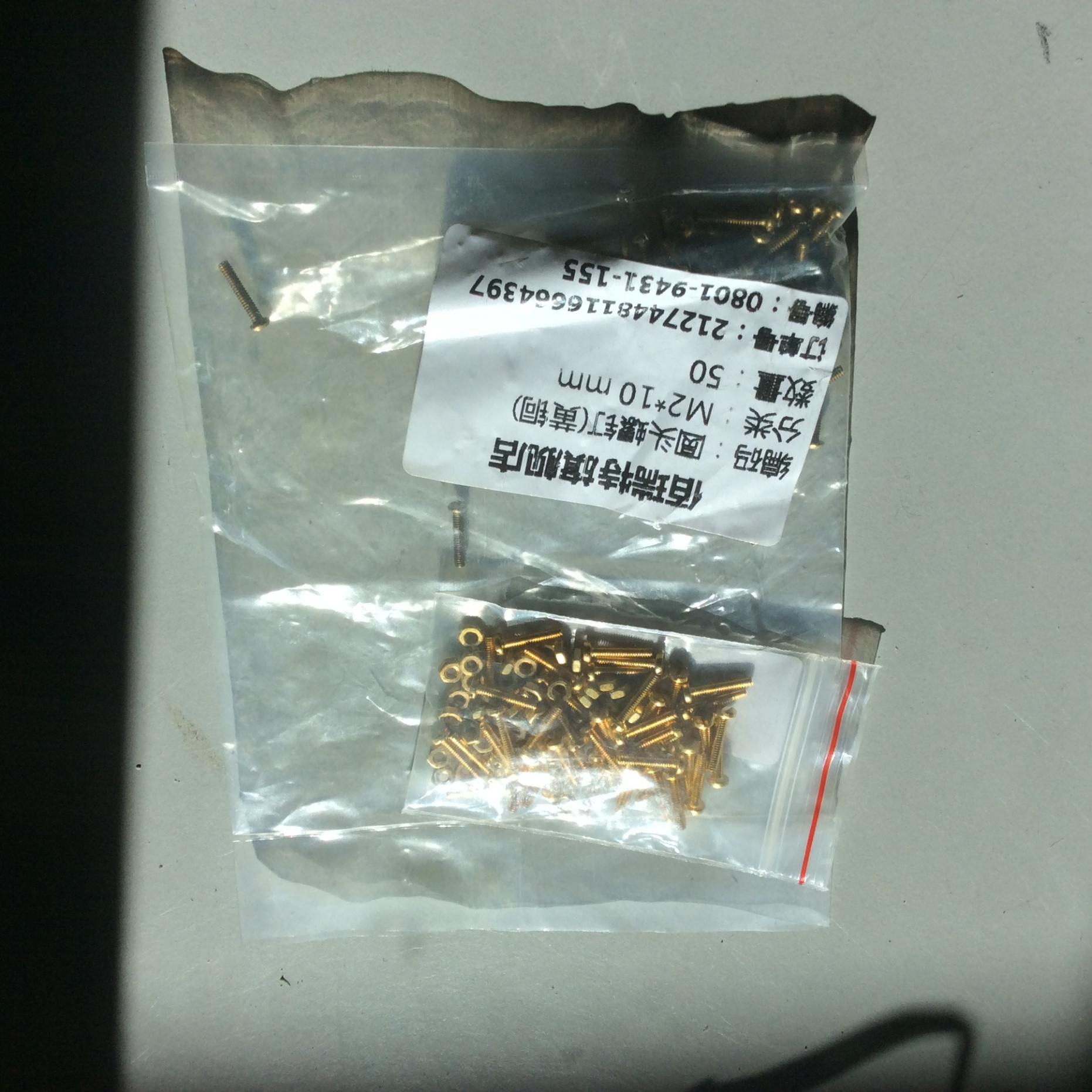

    Just thought I'd post this little mod that has reduced my crash damage considerably on my oxy3
    so far so good I'm using 3&4s batteries ( never tried it on 6s)
    i now use a brass bolt through the main gear to the main shaft
    when I crash it shears the brass bolt leaving the main gear undamaged
    & a lot less damage to the dfc arms/linkages/main shaft & blades ( feathering shaft still tends to bend)
    I've now crashed 7 times with the brass bolts & have noticed a big reduction in damage
    I bought them on eBay for a few quid , a bargain when you consider one main gear costs £5

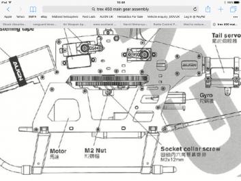

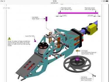

        Originally posted by terhoutd View Post
        Hey,
        Can you clarify what you mean by "i now use a brass bolt through the main gear to the main shaft"? maybe a picture would be worth a thousand words
        First picture is from the oxy3 manual, the second picture is from a trex 450 but is perhaps a bit clearer
        Nearly all heli's I've owned are made like this ,the bolt I'm talking about is the ( scoket collar screw ) in the second picture
        it goes through the main gear assembly & the main shaft
        I've replaced the high tensile steel Bolt with a brass bolt , when crashing it allows the brass bolt to shear first & helps to prevent damage
        to the main gear/main shaft/linkages & blades , the original picture is of the brass bolts I use in the oxy (m2x10mm )

          Originally posted by Dean airwolf View Post
          Kenny
          Can I buy them in bulk lol.
          Did you notice it's a pack of 50 I bought lol
