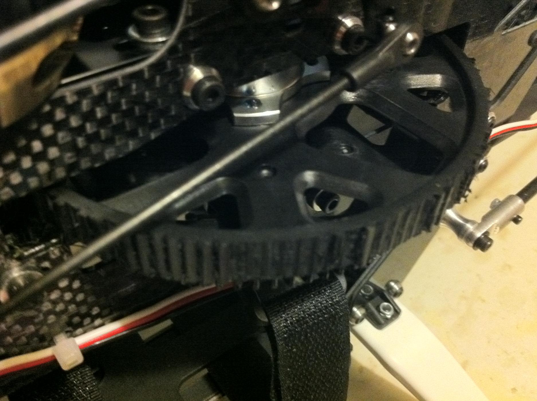

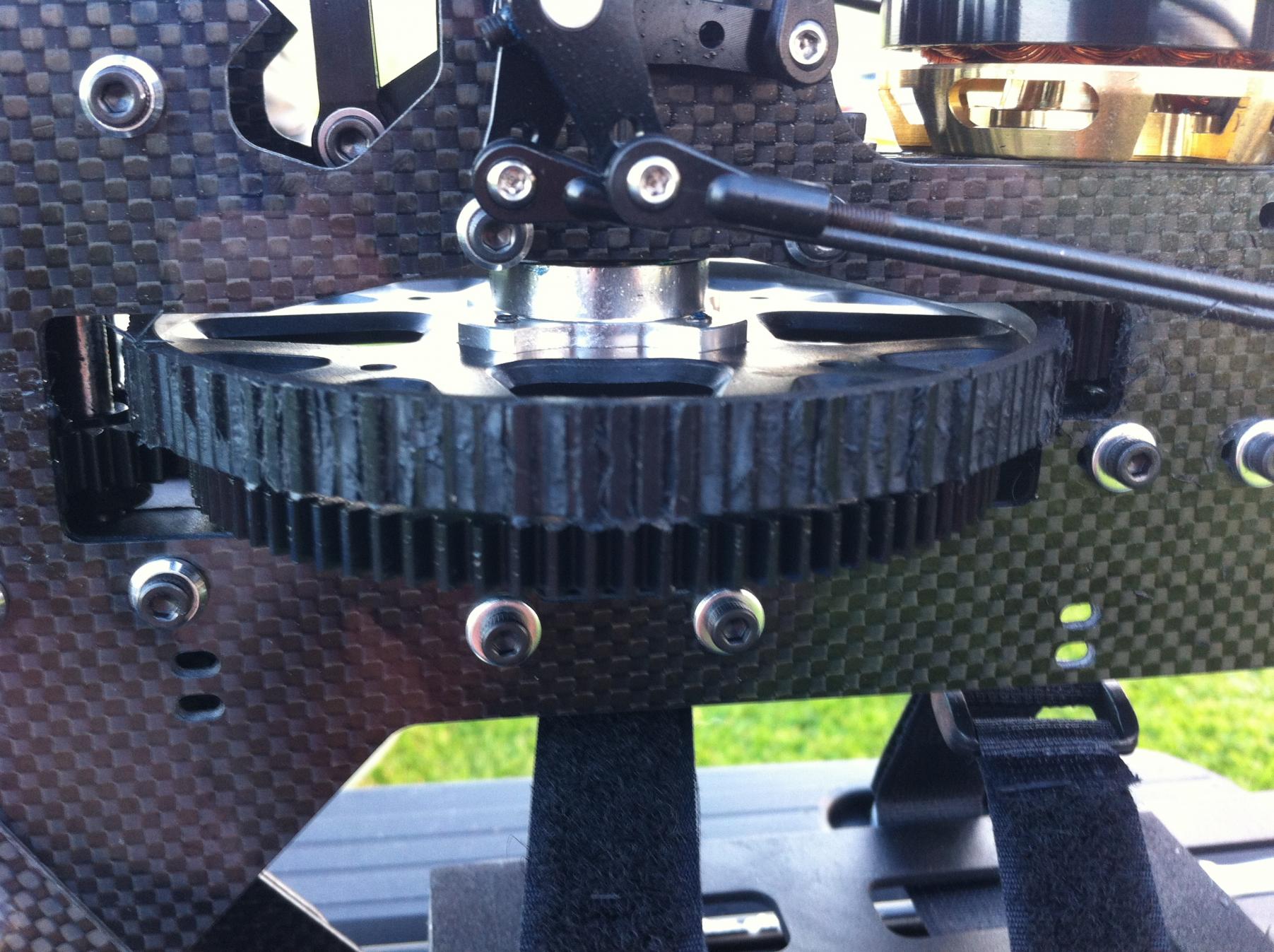

                    I know I'm resurrecting and old ish thread but I've had the same thing happen to mine tonight!
                    first flight of the night (10th in total/approx 90 minutes total time) , gave it full collective and cruuuuuuunnnncchh! stripped the main.
                    Surely they are not fit for purpose? I'm only using a 4025-550, gawd knows what would have happened if I'd used the 4035!
                    Luckily an easy auto.
                    I'd covered every base I could find during the build, I even asked a field rep if there was anything I should know.
                    I epoxied all the umbrella gears and meshed them to perfection, the main was butt up to the pinion with no gap and after the first 2 flights to bed them in had been lubed with Tamiya ball diff grease. All the motor screws were tight and threadlocked. HS was only about 2000. Such a beautiful, mainly well engineered model spoiled with rubbish gears!
                    Do I take it the white delrin CNC one is the one to go for?
                    Is it likely that any of the debris from the disintegrating gear will have caused any problem with the tail drive gear below it? or worse the somewhat vunerable umbrella gears?
                    I got the bit about the older white injeted gears being replaced with supposedly better black ones but only after having one of those strip did I realise they had been superceded again by a white CNC version!
                    AAAAARRRGHHH!
                    Do outrage do a white CNC tail drive gear too? (not the umbrellas you understand)
                    If so, is it required to stop the fusion from performing in flight self destruction?

                          There are new machined delrin gears on the way, not sure when though for sale. What ESC are you using as too high a gain on the governor can cause the issues you're seeing. Luckily I haven't had any strip in flight
                          This was just in normal mode (no governor), and only 77% throttle max

                            Harry,
                            Honestly, what is that monster gonna do to your gears if it's little brother can do this at only 3/4 power
