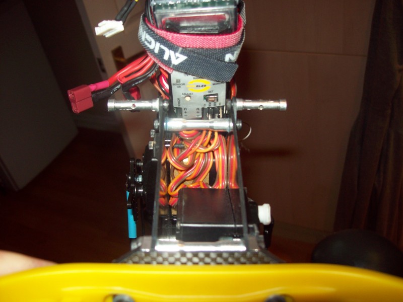

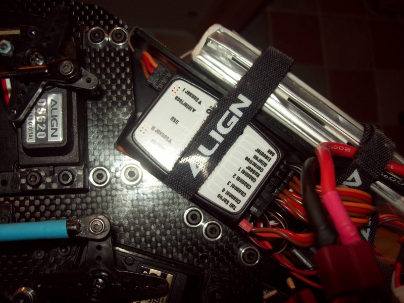

    Im just preparing my Velo 50 for when I order my Vbar Monday and am thinking that its going to be a right pain to put it anywhere. Where's everyone put theirs? I have a Align 2-1, AR7000 receiver an Align Gov and A spectrum regulator for my S9256 and throttle servo and then the Vbar to put on. Or should I just upgrade to the Pro and get rid of the Align gov and buy another satalite so I just use the Vbar as a reciever? Is it good enough to run 2 sat's from the Vbar?
    maybe this will help-note both sides of the frames i dremeled a little where the RX and VBAR sits to get more room.
    FYI i had the vbar sensor out the back.

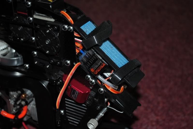

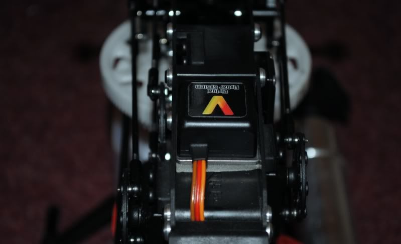

      Run sats on the vbar
      Control Box on one side, with sensor on the top.
      Reg down the other.
      Can look really neat.
