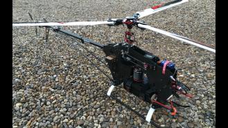

                  What does the V2 weigh? It looks light - I can't see where the weight is.
                    The weight is due to the fact it is big. Everything is chunky. It's not a light frame but boy is it solid. Lots of options too run from a 700 up to 810. I would say mine is a decent setup but no extras so weight wise pretty light compared to some. Mine comes in at 5.55kg. My Tri JR Ito in comparison which swings 3 x 720mm blades comes in at 4.8kg and its lovely to fly. Protos is a beast but sometimes nice to fly a thoroughbred.
