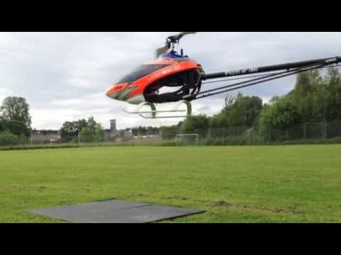

              I yesterday maindened my recently aquired Logo 600SE.
              I have a Actro 32-3, 555kv motor and a 90 amp 6S ESC, like yours.
              I put in this ESC while I decide about my final choice of ESC, so I can
              test the heli and experiment with low RPM, meanwhile.
              I have calculated that my RPM on the video is 930.
              I hope that number is correct.
              I had just over 4,0 volts per cell after a 6 minute flight. That is
              some 20% used and 80% left. I could have flied 15 minutes
              to storage or 24 minutes to 20% left. The average current was
              10 amps (≈250 watt) during the flight.
              I would say you could run with 6S, but what will the current be?
              With your motor, the Kontronik Pyro 650-1030Kv you should be able to get
              a reasonable power and RPM with 6S, but if you use 2,5 kW that is 100 amp
              att 25 volt. If you can limit the current to 90 amps you should be OK.
              If you pull more, you will probably burn the ESC.
              Logo 600SE, with 700 blades and 6S at 930 RPM
