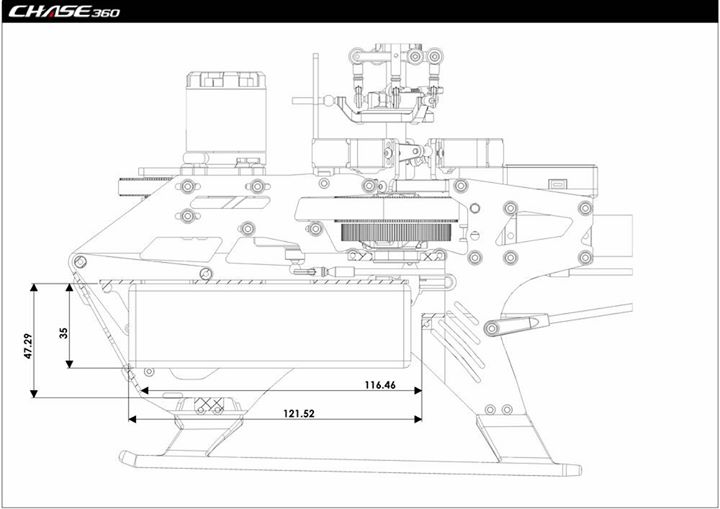

    OK so Glen the designer just posted this on HF
    The bounding box for the lipo to fit is
    40mm x 46.7mm x Unlimited* (120mm)
    *To fit unlimited length requires tail servo to be mounted in the upper front location option and in order to achieve correct CG the front esc tray may need to be removed also.
    Length is dependent on how tall the lipo is. The esc tray on the front angles back so the taller the pack the less room it has, but in general 120mm between the tray and rear tail servo mount,(a must for mounting mini servos) I prefer my tail servo in the other location, this leaves clearance for unlimited length, but CG may put the lipo into the front of the frame. The heli performs fine without the front tray. So anyone wanting to do some weird and wonderful things will have some flexibility.
    So now we know what lipo sizes are possible.

                              Info on battery space available
                              Frames are 40mm wide.
