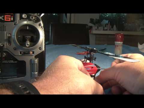

    Hi guys, my BNF mcpx has just arrived and i am having trouble understanding how to bind it to my dx6i , it says hold down the bind button while turning the tx on ...but iv taken the canopy off and checked the heli and i cant find no bind button?. can anyone help please

    There is no bind button on the heli. Just plug in lipo and then bind with tx. Easy.

      The bind button is on the DX6i, here you go

        I think the bind button is on the transmitter.
        I read recently (I'm getting a DX6i Saturday) that you hold the bind button in on switching on the transmitter and you then have 12 seconds in which to power up the heli. Don't recall what happens after that other than there's some light flashes and colour changes signifying yay or nay. I'm sure someone here can explain it fully.
        EDIT: Martyn beat me and his advice has helped me, too. Thanks, Martyn.

          Plug heli in, hold timer switch on DX6i whilst switching the TX on. Tx should bind to heli (solid blue light on MCPX etc). Can't remember how long, but you will know when it has bound and you can let the trainer switch go.

            I did this not long ago.
            Create profile for heli on TX as per settings you get with the CD (Regarding pitch curves etc etc). Turn off TX. Plug in heli, wait for the blue light to come on behind the canopy and flash away rapidly. Hold teh "trainer" switch up on the DX6i and switch it on while holding switch. Keep switch held for 5 seconds, let go.
            Wait for the servos to arm and the MCPX and then crash it till your hearts content

              Thanks guys and gals for fast response and thx Martyn for the link.....should be up and away in the next ten mins ...will report back
