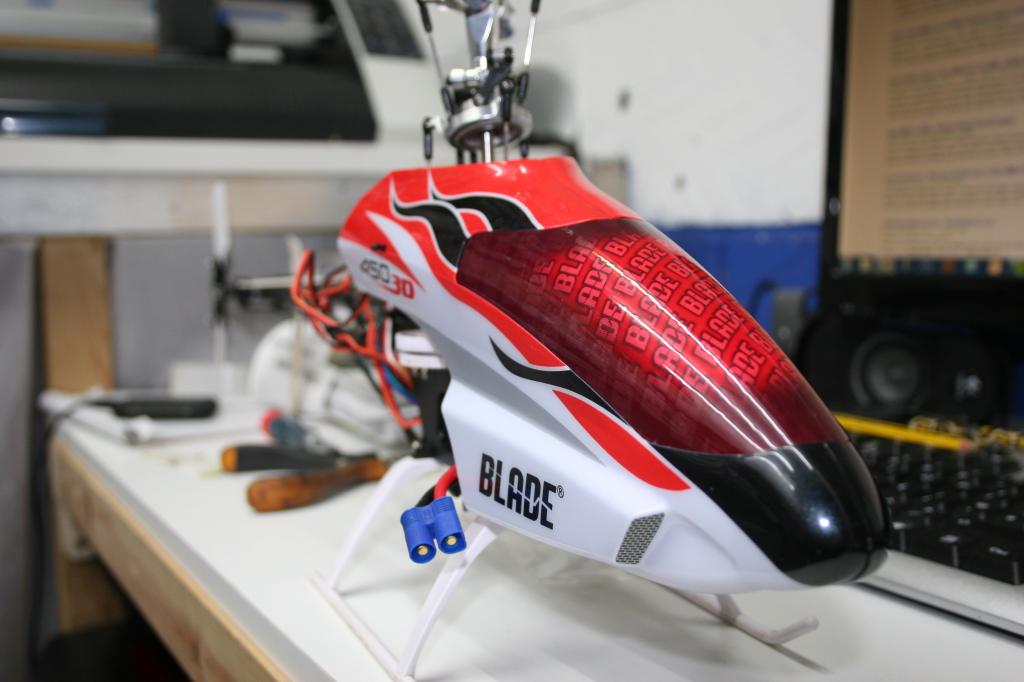

    So I bought a 450 3d from a guy on here Tom, and I have already done a few bits and pieces to tidy it up a bit so thought I would start a post here about my progress.
    So when I first received it it looked like this:
    Lovely aluminium FBL head
    So started to unplug all servo cables, learning what goes where and taking photo's as I went along I started heatshrinking all the cables so they look lovely black.
    All servo wires nice and sleeved:
    Starting to hide the cables:
    Moved the 3GX unit into the bottom ESC tray, swapped the ESC round so the cables weren't dangling about all over, and put the receiver up top:
    All looking much nicer! Decided to have a fly on the drive last night (we have a drive big enough for 5 cars so plenty of space) and managed to catch the blades on a box that has the rabbit food in - safe to say I was in the model shop this morning buying more tail rotor blades and main rotor blades. I have also bought a new main shaft + bearing to replace the current one as according to the guys in the shop this could be causing some vibration in the heli.
    Thanks again to Tom who has been an excellent help in getting me up and running, without him helping me on Wednesday night I would have struggled so thanks again mate.
    Let me know what you think guys, and if you spot something that could potentially cause me trouble please let me know.
    Mousey

    Oh come on! - I didn't have the cables hanging out like that! They were cable-tied in place!
    Seriously though - amazing difference! Fancy popping down to Bath and tidying the cabling on my Goblin?
    Make sure however that the 3GX is secure! Bearing in mind, it has the 3x MEMs gyros that detect movement in the heli. They can be very sensitive to vibration. It was resting on a specific pad where you've now got the receiver and you may find that proximity to the main shaft, and lack of solid base to fix it to causes you problems.
    Fundamentally, if the 3GX can move AT ALL, you need to swap it back I'm afraid ...
      PS. By specific pads, I mean this stuff HEP3GX01T | 3GX Double Sided Tape
      Which shields the 3GX from heli vibrations.
        Oh yeah sorry - they were indeed cable tied in place I must have gotten snip happy before I took the first photos! Haha. And yea for sure - teach me how to fly the 450 and I will tidy your goblin cables
        The 3GX is secure enough (i.e I cant move it if I try pushing on it etc), but I wouldn't want to cause any problems. Perhaps I should move it back to be safe....hmm back to the drawing board on how to wire it up again...lol
          Just ordered some more of those pads....
            Try sending a PM to a guy on here called Coolice (Ian). He's the expert on 3GX setups. I would worry that the zip tie may be transferring vibes from the body to the 3GX. The double-sided pads are designed to dampen those vibes.
                        Hey.
                        I'm with Tom and you've probably changed it already, but I wouldn't use a zip tie to keep the 3GX in place should the sticky pad fail. I used to wrap an Align velcro strap around mine, loosly though to allow the double sided foam pad to still do its job of reducing any vibrations being transfered to the FBL unit. There was a time when fliers were strapping the 3GX down tight, compressing the foam pad, but it's not ideal.

                          And yes I have changed it back to the original position up top with a 3gx sticky pad under it. Was bobbing around the garden again yesterday, all was well until the tail servo gave up
