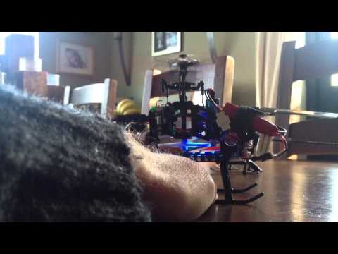

      Except, it's still a fault. Even though you found the same "workaround" I did, after paying >£150 for this, I think you should have one that's working perfectly - at least, out of the box, before it's crashed a few times!
      A fully functional 130x does not exhibit this behaviour. HH know this, and will replace it.

          Think your prob was different to the OP's though Tom.mine spools up great to the point it gets light on skids,from that point on it tips to the right if you don't pop up quick.
            Nick - check out post #4. The OP actually shows a video that I posted on youtube of my personal, original 130x and says "Mine is the same minus the vibe." On that basis, I assume the OP's heli is showing exactly the same behaviour!
            Check out also my later post showing my new 130x which is quite capable of being light on it's skids whilst resting on the floor.
              Ok,hold your 130 and spool up holding it still,the swash does not stay level,this is what I'm getting at.
                Can't recall the last time I saw somebody holding a heli down while taking off , but I thought I'd try .. As you can see, my swash stays level and eventually the downdraft blew my iphone over!
                  I don't mean hold it down,hold it in your hand
                    I just tried mine and i it stayed level lol....but i,like you have no vibes what so ever.....when mine was stock the bad tail vibe would upset the gyro's and it would tilt to the right.
