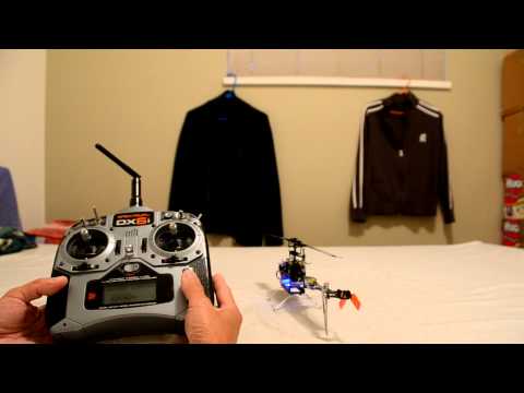

    Just got a blade 130x i have copied the settings to my DX8 ,
    in the throttle hold position everything works fine when you increase throttle the swash moves up smooth and you have full cyclic movement but as soon as you put it in flite mode at zero throttle you have full cyclic movement then once you increase the throttle the right hand front servo drops down the swash tips over as you increase throttle then you have no control of any swash servo's or tail servo untill you drop the throttle back to zero
    i don't think its a servo problem because it works perfect at zero throttle or in throttle hold , could this be a transmitter setting ?????????

    You mean like this?
    http://youtu.be/vHFmz7jH7N8
    Sent from my iPad using Tapatalk
      YES TOM , Thats what it is doing , do you know what the problem is ????????

        Hi Phil,
        Yes - its a mainboard issue on the 130x. That video was of my first 130x. I sent it back to Horizon Hobby in Essex and they replaced it. The new one worked perfectly. Bizarrely, the symptom is only there on take off as the blades spin up to speed, and BEFORE it's in the air. Once in the air, it will fly fine, but it takes a leap of faith and a quick take-off! So, you have the following options ..
        1/. Ignore it, and take off very quickly!
        2/. Send it back to HH in Essex. If so, phone first and talk to Garry Brace - perhaps email him this thread.
        3/. You can get around the issue using subtrim - see vid below.. (this is a workaround rather than a fix though, the problem is still there!)
        I would go for option (2) personally. HH support is excellent!
        Cheers! - T

              I think that a lot of this problem is caused by vibes. Did you see in that first link from Tom how bad the heli vibrates and that's without blades!! He probably had a bent main shaft.
              On my first 130X I never had any of these issues. Then eventually I updated the motor to the spin 8000 and had left the IU 1&2 the same which is like 100% in 2. At 100% the vibrations were immense on the heli and guess what... It started doing the tip to one side thing! I reduce the TC to about 80% no vibrations and tilt on spool up left.
              My most recent 130X had loads of issues from the box. Bent TT, locked tail blade grip of the tail shaft. Bent tail shaft etc etc any how all this lead to awful vibes on spool up way over the norm. After replacing these parts the vibrations went and it flew normally. Saying that these vibrations weren't enough to cause the tilt on spool up. So I think it depends on where the vibes are and how bad they are to how affects the 3 in 1 board.
