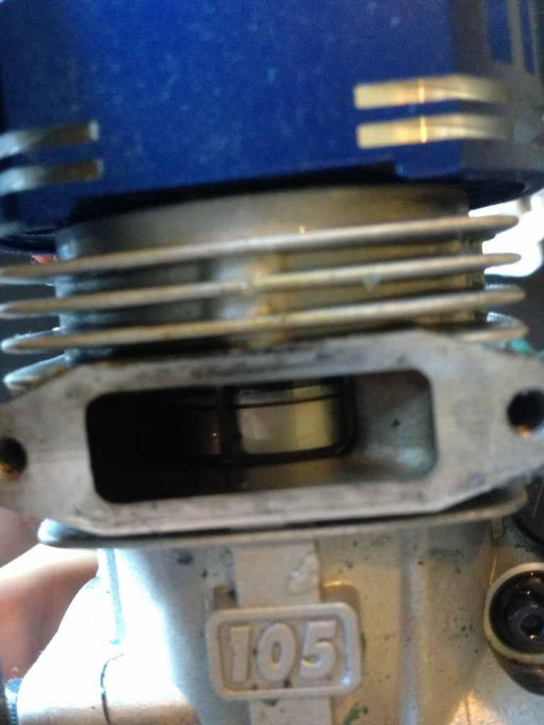

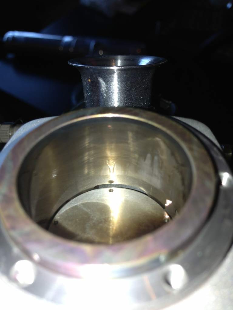

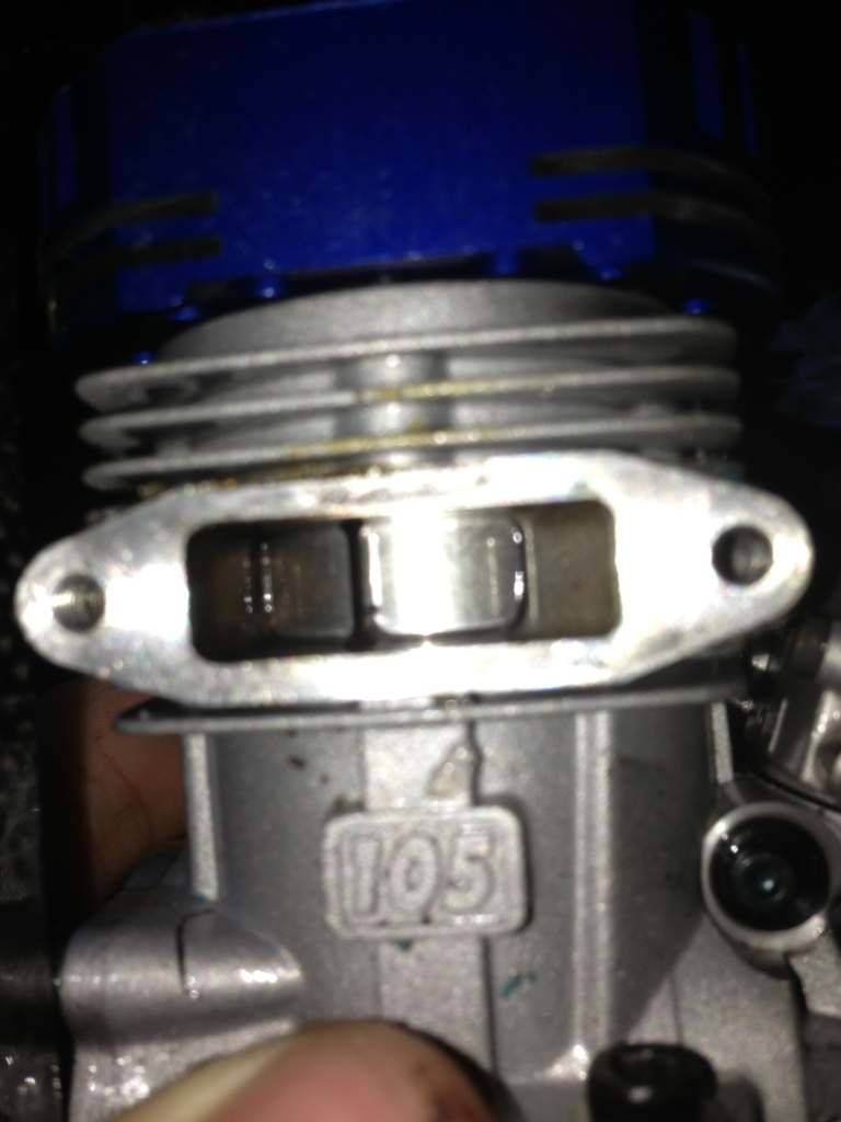

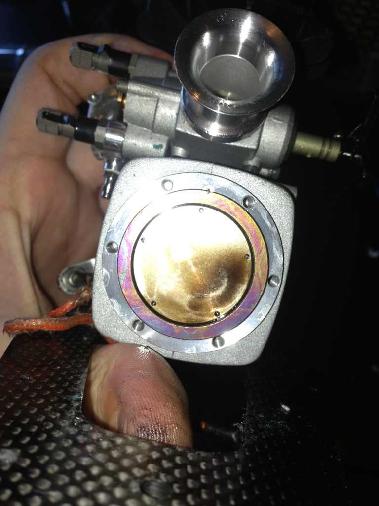

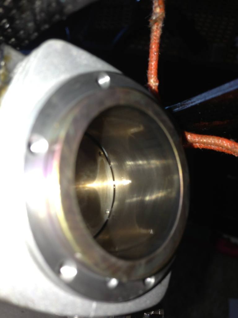

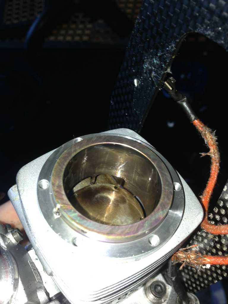

    Looks like its been run a bit lean (I knew that) But nothing too serious.
    Just seeing what other people think as I have no idea really!
    Any input appreciated

        looks fine to me.
          I generally look for any scores in the piston liner and piston if all smooth but compression low then I replace the piston ring and bang it all together again. If any scores on the liner or piston then I replace them all..
          Stuart
            looks fine to me too. give to a good rub with some alcohol wipes and all should be good to go again
              Looks ok to me too, at the bare minimum id be tempted to fit a new ring while youve got the engine out.

                Looks OK to me. It might be worth replacing the bearings while you have it apart, you can also look at the piston ring itself when you take it out, but from what I can see its fine. I assume it runs ok and there is plenty of compression and it sounds alright?. I always check the temperature by putting a finger on the rear of the crank case and if I can leave it there without me haviing to take it off because its too hot to touch then the engine is not running too learn.
                Hope this helps
                cheers
                Dave

                  Looks fine to me, why do you think it was run lean?
                    Because it was marked, i saw on a video once that the piston should be clean or it has been run lean.
                    I only took it out to have a look at it, its back in there now! (Although I have put a shim in there)
                    When your tuning these you tune so it sounds right rather than for maximum power dont you? (I.e it'll make more power lean that it will when its just right?)
                    Just wondering when to stop. I think I had it roughly about right before, now I want to muck it all up again and tune it myself for practice sake
                    TT Raptor G4 + Vbar
                      Nothing wrong with that piston!

                          Year, piston looks fine but what's going on with the insulation on those wires?
                          Marty
                            without looking at the whole piston you cann't tell if ifs ok or not correctly
                            but by the pictures shown it is servicable
