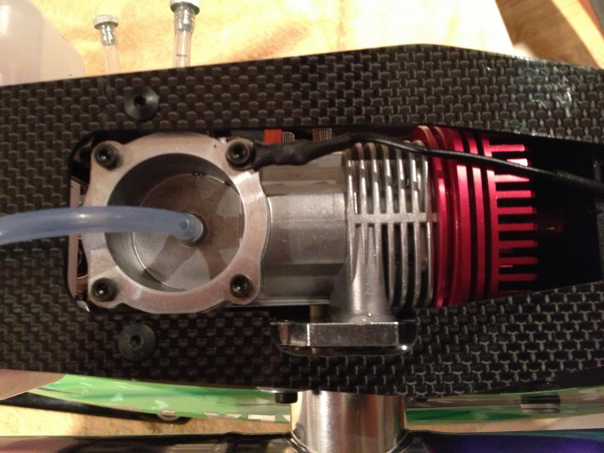

          Considering align have made this heli with the big block engines in mind they've overlooked this. Look at the size of the cutout I've had to make just to get the 120's header in!!

            But that looks like a Hatori pipe. A fine pipe I'm sure (and I have a couple), but I always end up fetling to get them to fit helis, which usually involves taking that lump of metal off the bottom of the header rather than a hole out of the carbon of the heli. Usually have to take a great lump out of the cooling shroud as well.
            However, to be fair to Align, I bet you wouldn't have to make any adjustments at all if you fitted one of their own pipes.
            The obvious question to me is - why do Hatori pipes always have that bulging lump on one side of the header anyway, and why is the header always handed?
              But thats my point, theres only two big block engines on the market and only one pipe for the YS120 and thats the Hatori! Align dont make a pipe for the 105/120
