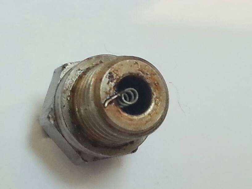

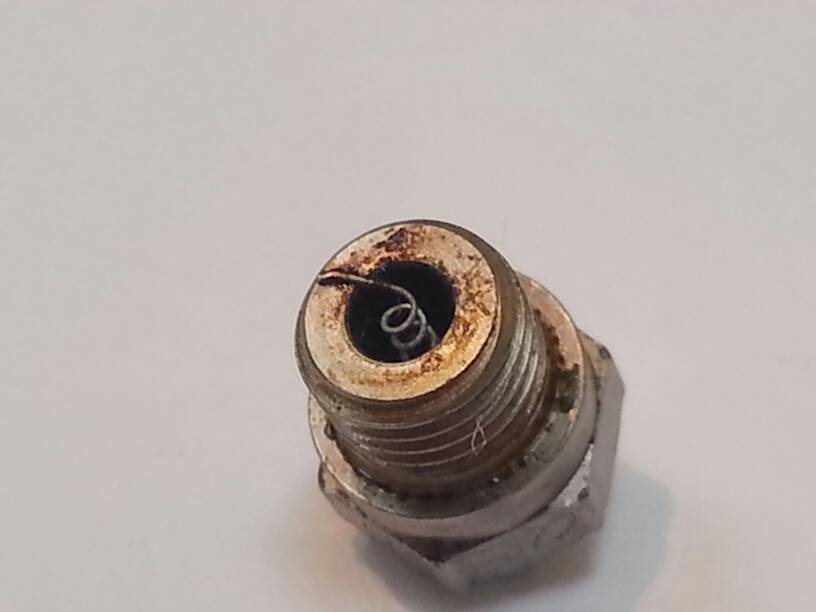

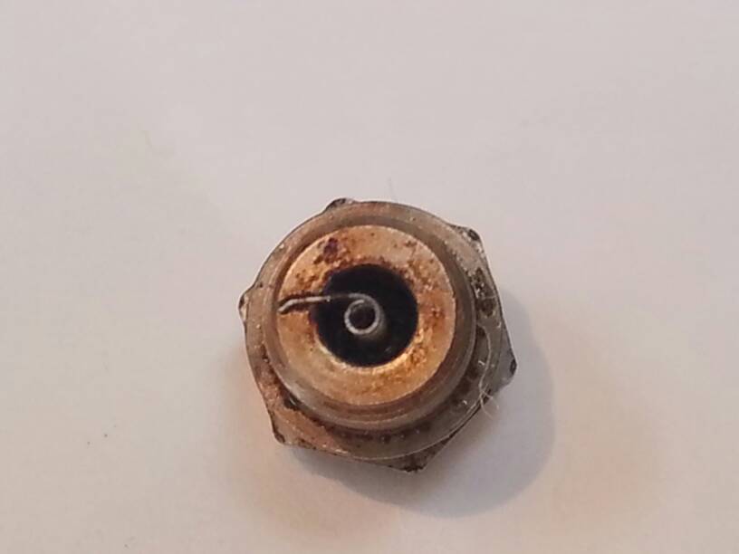

                        So I had the engine stripped down after the glow plug failure and had a good look.piston , liner and bearing all look as it should.
                        I have attached few pictures of the failed glow plug in case someone can see anything wrong.
                        sigpic X 2
                          It looks like it's got very hot at some time and you're running a bit lean as the element is very dull in colour, also whats the brown deposits. I never have that in my engines?
                          What engine is it and what are the needle settings
                            +1 on that! Something not right there hope someone can sort you out soon.
                            sigpic thank you.
                              Thanks Dave.
                              Engine is a os50 Hyper.
                              Mixture control screw as per factory settings.
                              Needle valve 1 and a quarter ish out. Plenty of smoke, nice power but with out sounding too p$$ed off!
                              Those brown deposits are difficult to see. But taking the picture in macro mode looks horrible! They will scrape out. Makes me wonder if I was running it too rich and that's oil deposits?
                              sigpic X 2
