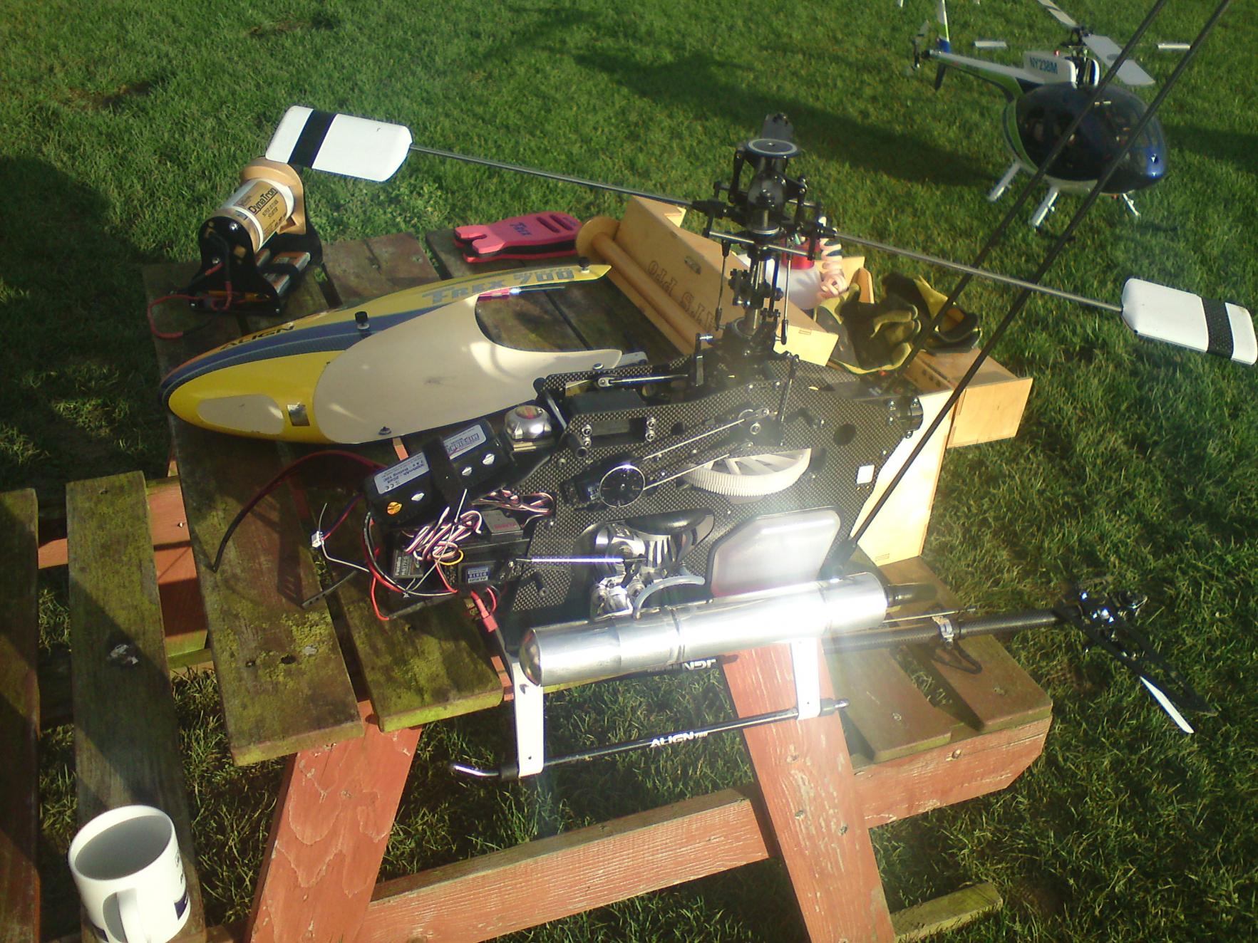

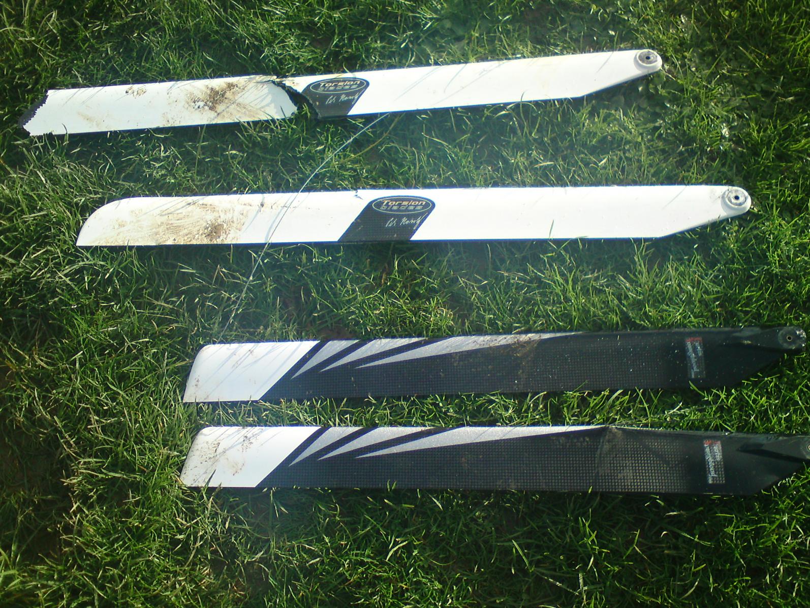

    Managed to come back home with a completely totalled trex 700.
    Had a normal flight with it, didn’t necessarily put it through any more torture than it does every flight, got about ¾ of the way through the tank and decided to land because the fingers were getting a bit chilly so brought it into the hover about 10 (ish) foot off the ground ready to land. Then all of a sudden the model started shaking like mad and chewed its self up in the air and plummeted into the deck. Of course I was in shock and had no idea what happened, when we went to retrieve the wreckage we couldn’t find the tail rotor around anywhere close. Started searching the field and fount the rotor and blade holder in tact about 35 feet away with a sheared bolt.

        The worst bit of them is the loss of the blades, not good

          Thats why I keep so many blades cos thatys the one thing that ****es me off when I crash,blades.
          So i keep loads of pairs.

                    yeahh the blades are always the worst.

                      Throwing the tail hubs on the 700 seems to be a recurring thing. Done it once myself and know of at least a couple others. Whether it is fatigue or issue after a repair where the bolts have become stressed I'm not sure. I opted to fit a QUK tailhub.

                          Which bolt broke on the 700 tail?
                          The one through the holder and bearings into the hub we only discovered what happened when we got home and carried out an inquest

                              One thing we had noticed the last couple of weeks was slight foaming in the tank i think we checked every thing bar the tail blades the more i think the more i think that was the start of it.
