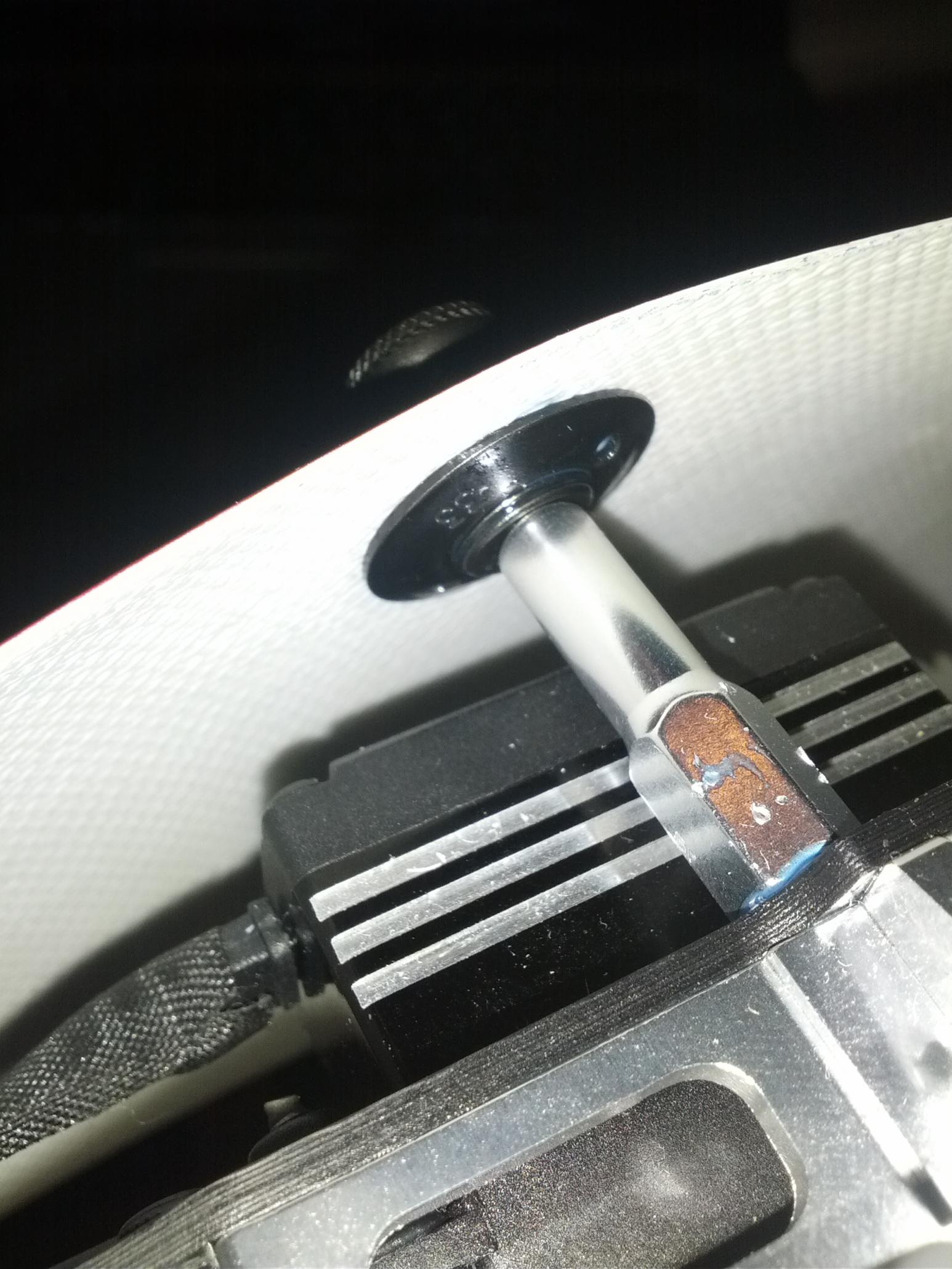

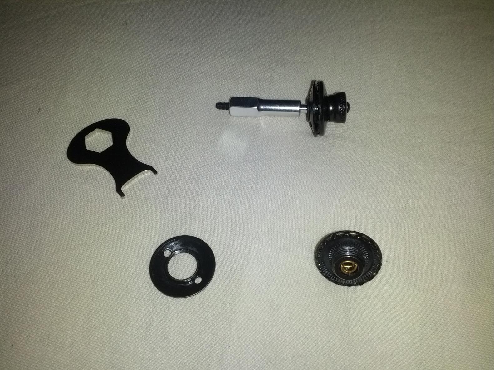

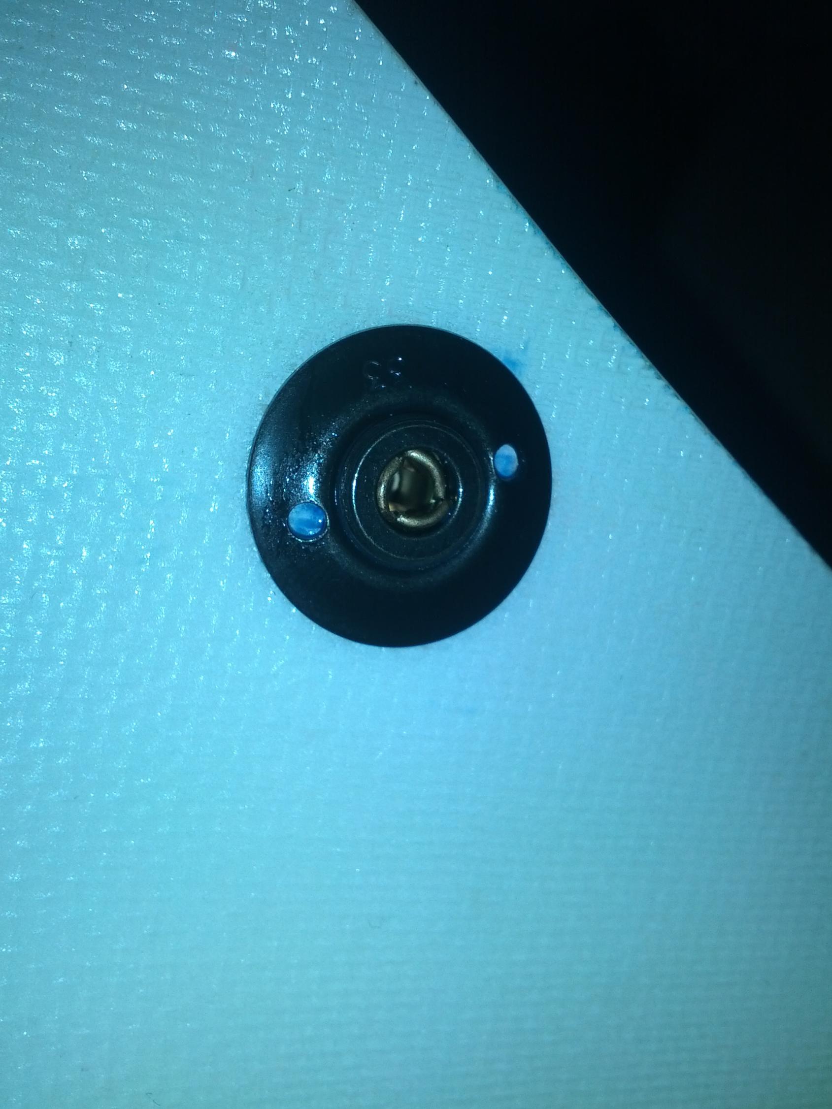

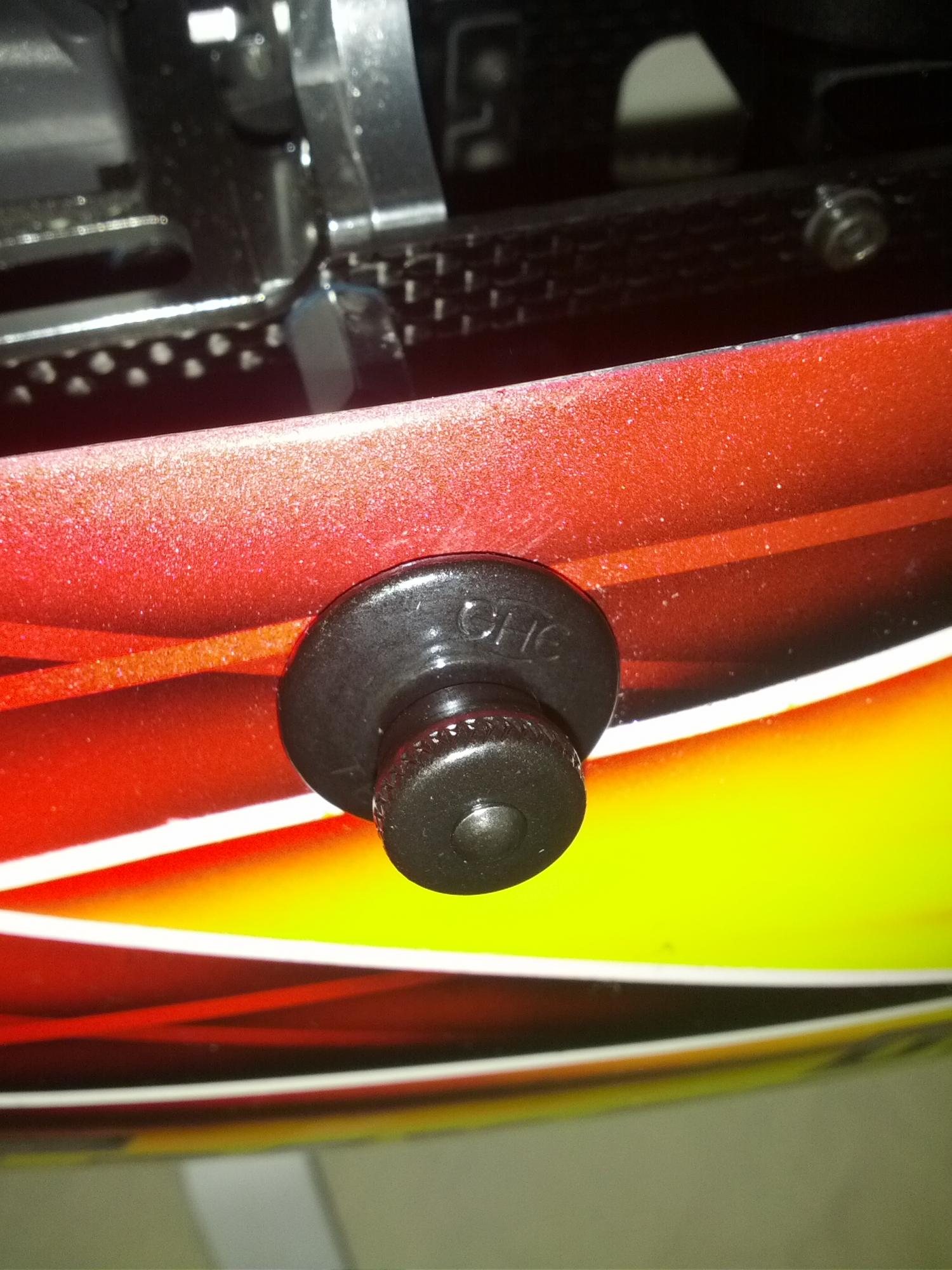

        this is what I use now on all my helis ... no regular nuts no r-pins and quick release that holds perfectly ... tenax24.de - 3.90eur each if I remember correctly ...

          Originally posted by r4nd0m View Post
          Carl,
          [ATTACH=CONFIG]65516[/ATTACH][ATTACH=CONFIG]65517[/ATTACH][ATTACH=CONFIG]65518[/ATTACH][ATTACH=CONFIG]65519[/ATTACH]
          Those look really good, what diameter do the canopy support balls need to be and which clamps do you use? Looked on the site and there's a few versions.
            just check these posts, they fit various standards standoffs ... I use them with my 550 dfc and 700 dfc
            http://www.rcheliaddict.co.uk/t-rex-...tml#post956301
