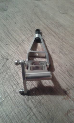

    Hi guys I recently crashed my 700n dfc and managed to twist the elevator anti-rotation bracket as shown In the pic. After searching around the web all I can find is the standard 700n bracket which only has the outer mounting position for the flybarred versions. does anyone know if or where I can get the dfc version?? Really bummed of I bent it Cheers Chris
    Do you not use the 700e one? Pretty sure that is what I did.
    Goblin black nitro, Trex 700N, Vbar control 👍🏻
      do you have a link to the part you used dude?? Muchly appreciated!!
        H70046 Elevator Arm Set is the only one I can find. If I was in the same situation that's the one I would order.
        Many of the similar size Align helicopters share parts.
          Thanks guys yep thts the one jus never thought of looking on the electric models for it lol.. thanks!!!!
            I've just got a 700N-LE that has been converted to DFC, I was told/shown that you use the the horizontal piece of the 700E (which the 2 links connect too) but use the vertical (triangle piece) from the 700N

              Yep thts how to do it
