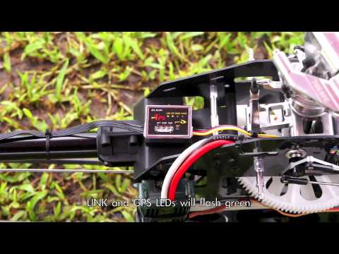

                  Here is a good video to, it's in Chinese but I used it alongside the manual with my first APS setup
