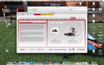

                      vbar says values between 40 and 60 ok
                      Sorry thought we was talikng about travel which is 80-120????
                        Not on express Ben 30-70 only pro which is 40-140
                        Troll buster
                          Am I missing something, mine defo says values between 80-120??
                          We talking about the tail setup, travel in either direction? This is Vbar 5.3.2
                          Edit* whys the pic so small?
                          I see what you mean, it allows you to go to these values you mention but if you read the text it says values between 80-120 are what you should aim for 80 suggests to far out and 120 too close in on the horn.
                            Ben your refering to pro version check out the express version.
