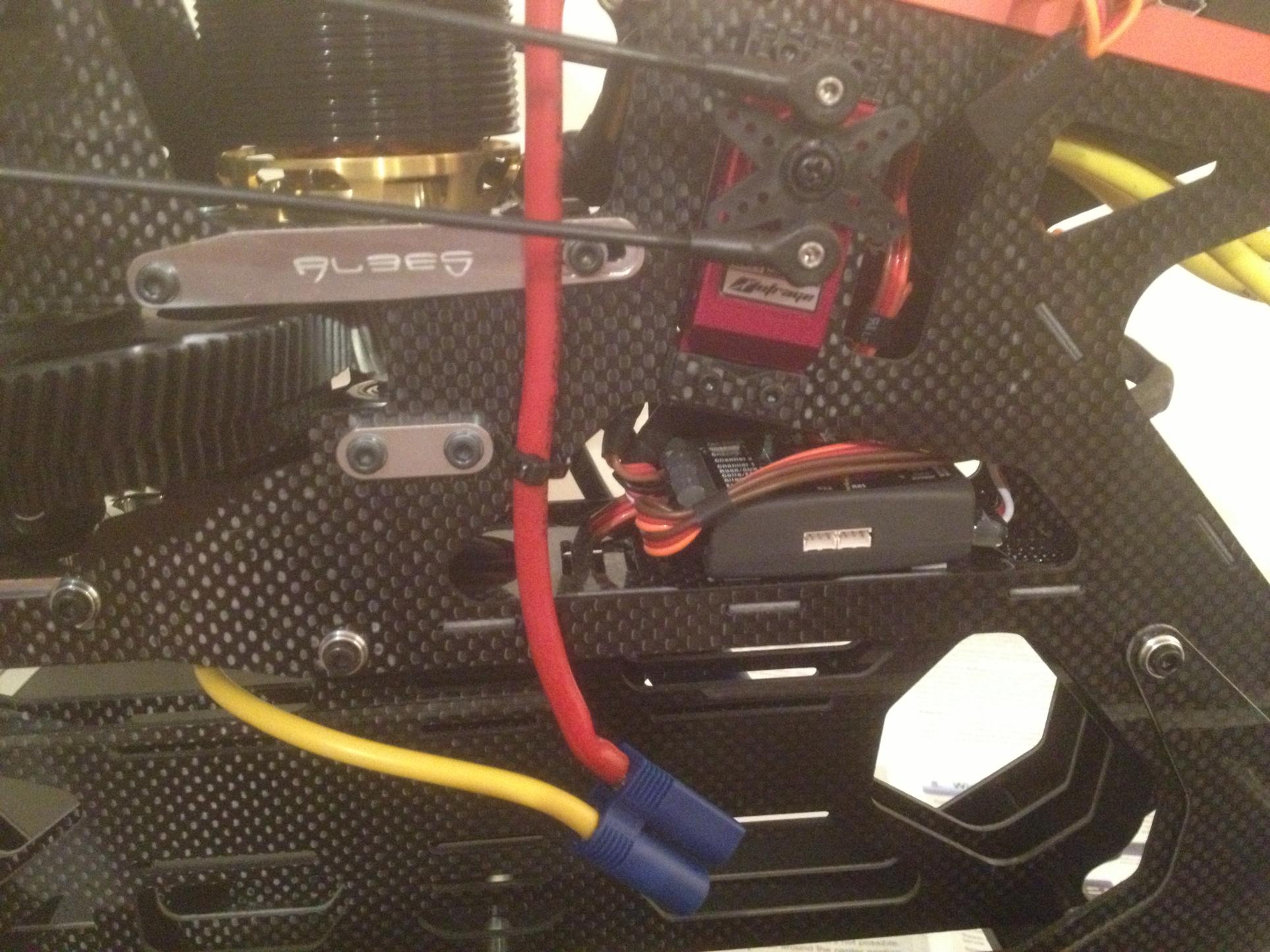

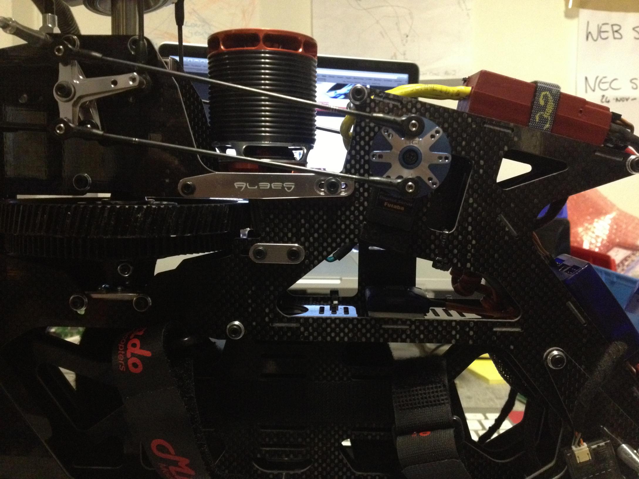

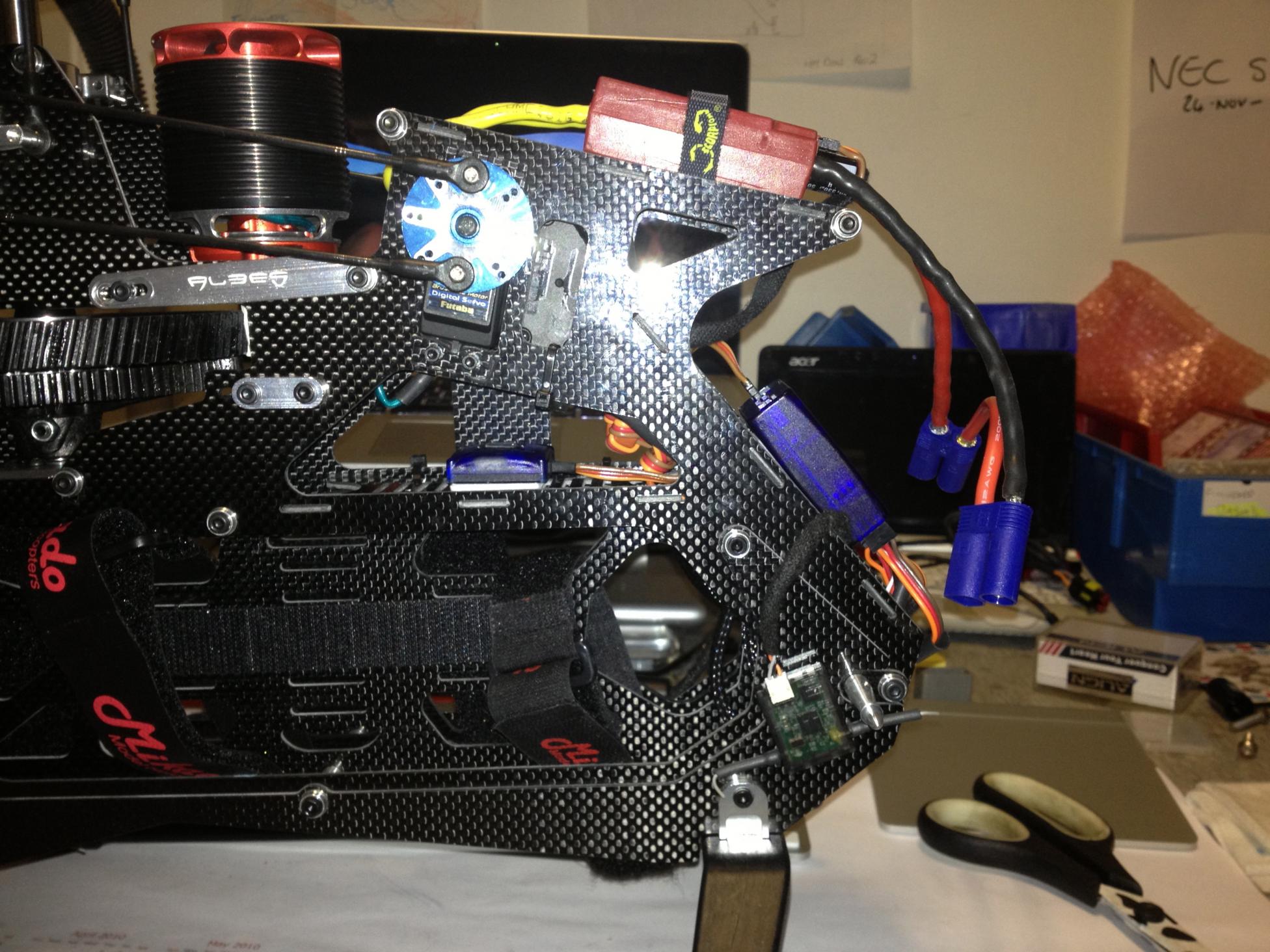

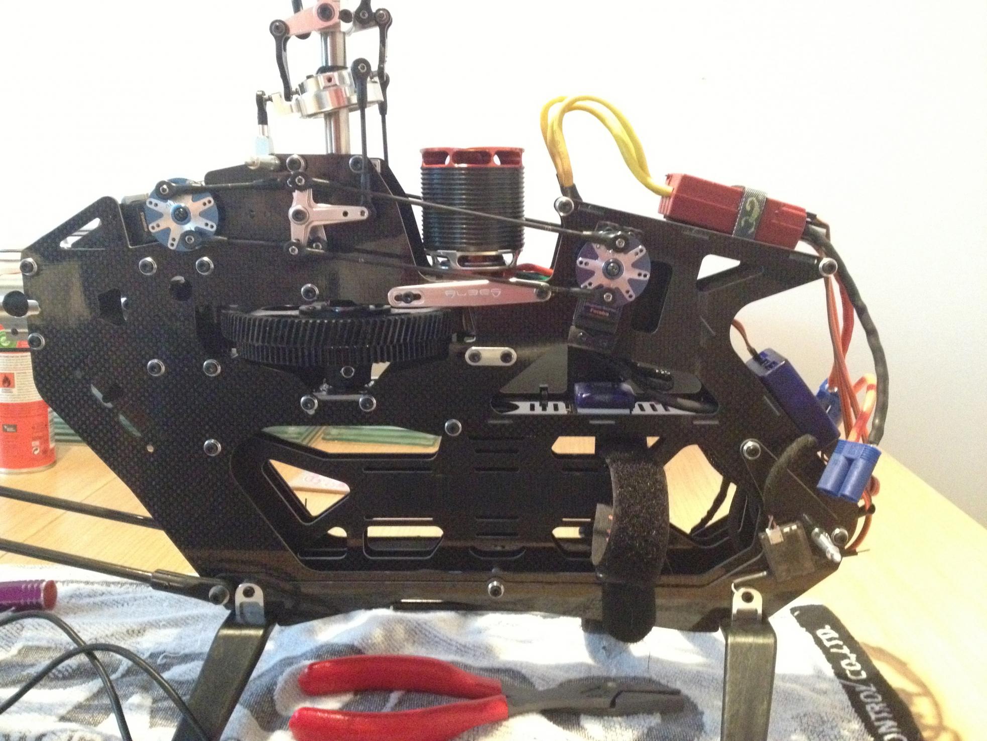

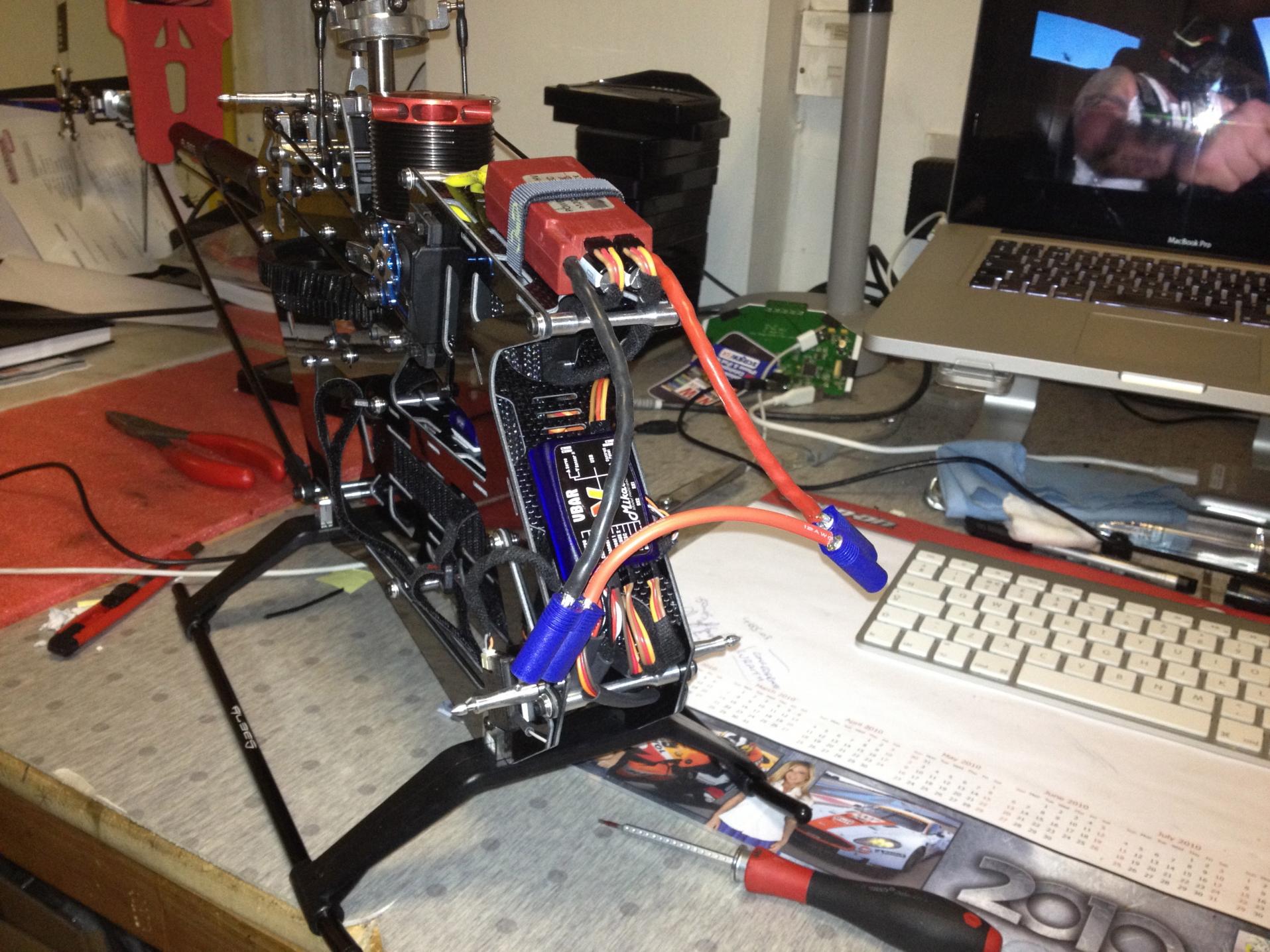

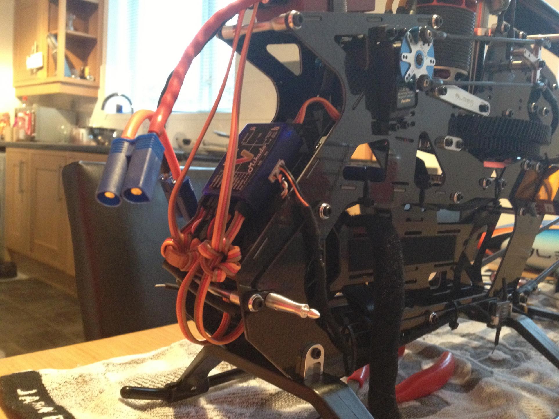

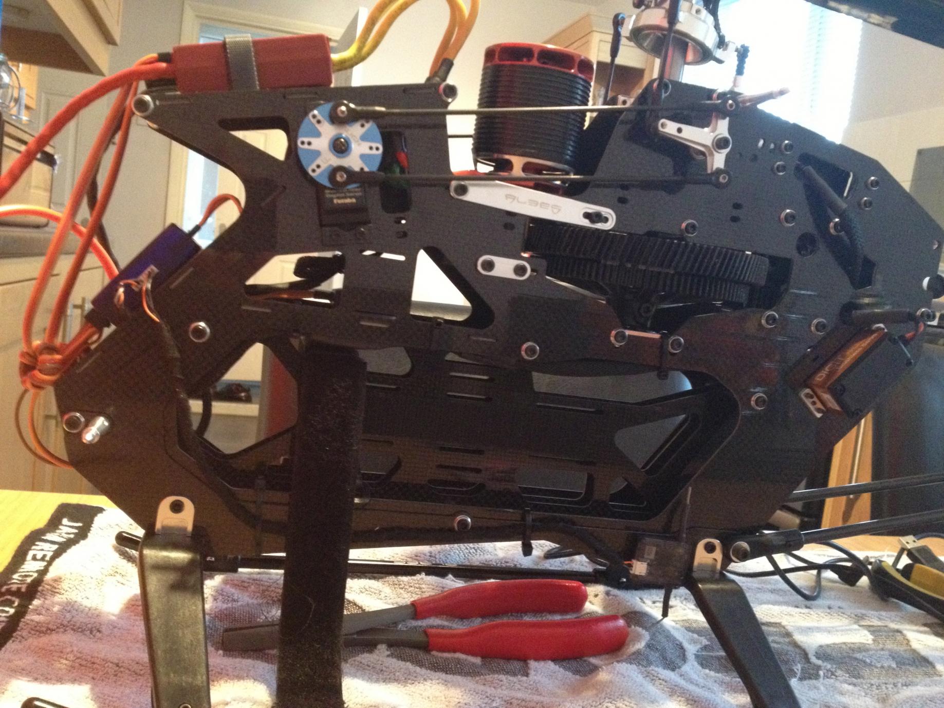

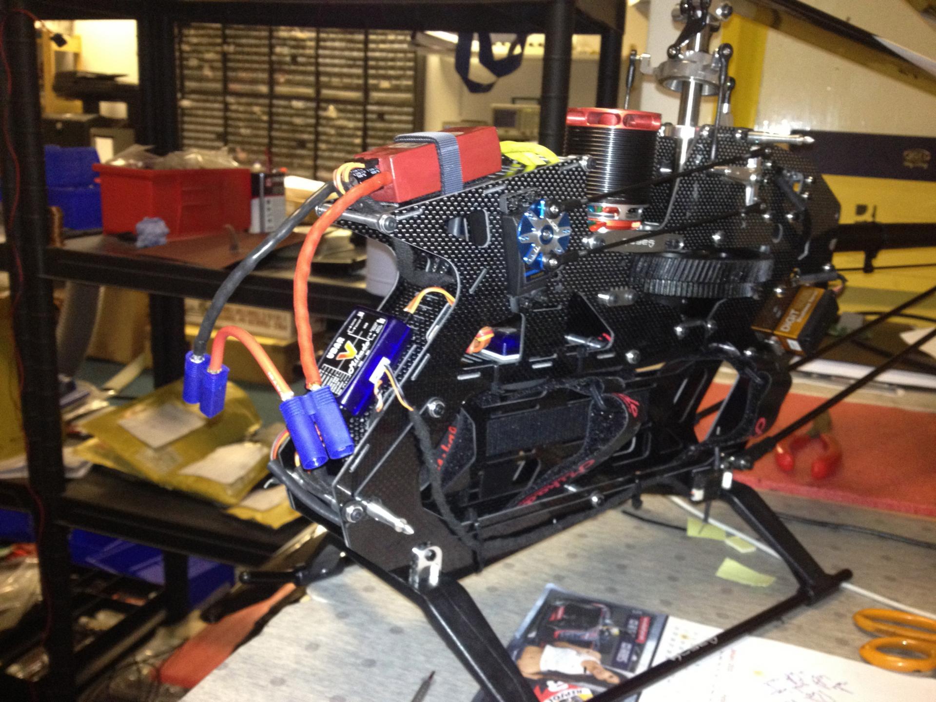

      Pics of electronic placements for Ross.
      • #48
        Nice Ben, i decided to install my vbar on the shelf where your sensor is mounted, i tend to crash nose in a lot lately, so decided to try to protect the vbar as much as possible, will post a pic in a bit

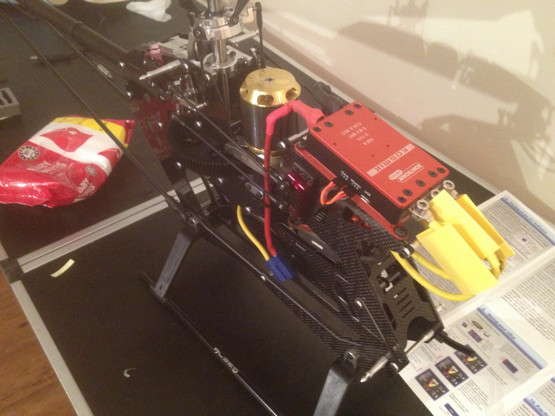

        • #49

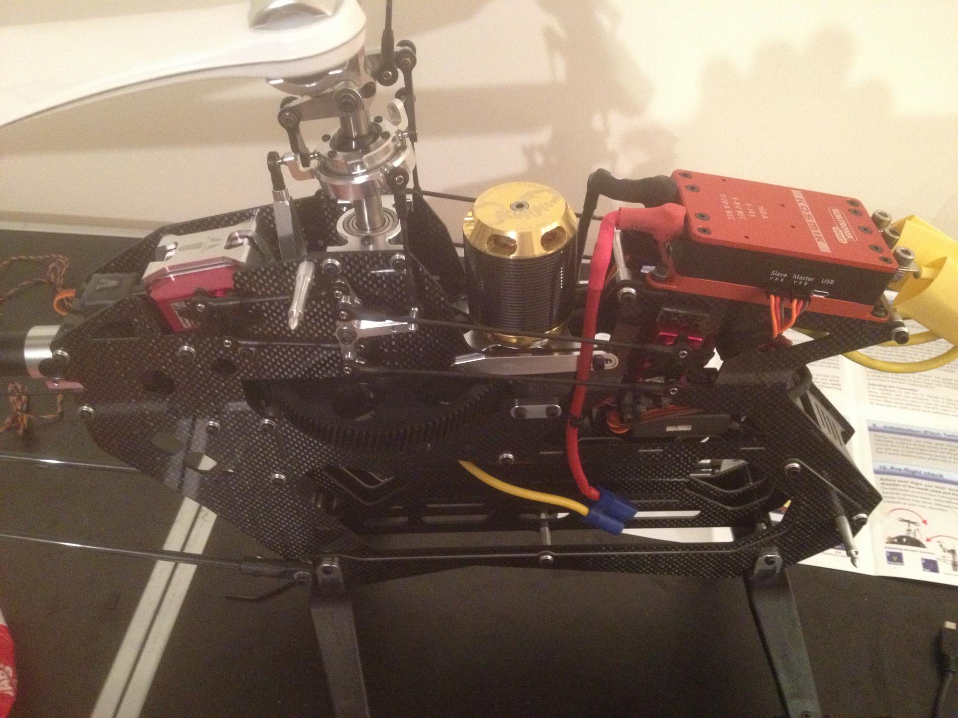

          Heres mine, plus as i was taking the photo anyway, thoght i would chuck in the fleet pic lol.

            • #51
              Originally posted by danch View Post
              Holy crap that kosmik is huuuuuuge
              lol, does look massive sitting up there. Tell you what Ross, that will really help with the CoG. I found with Optipower 6s 5000's I was quite forward with them. 4300's where right at the front and the 5300 Ultra's were about the middle of the cut out. Also, having the main power leads coming down like that you wont have to take the canopy of at all to swap packs.
              A tip, on the battery trays dont use too much velcro otherwise like the Xxtreme they will be a pig to get out. I learnt that from when I had mine so I just put a thin strip on there and its loads better plus the fact the batts are not as far in as the Xxtreme because of the separate trays with the spacers, it pushes them out which helps.
              Are your ball links tight on the balls? If so get a spare ball, score it with a sharp knife and pop the links on this. A few twists and they are sweet. Did mine this morning after reading the teams guys done theres this way. Not with a reamer as the way the links are shaped the reamer apparently does nowt.

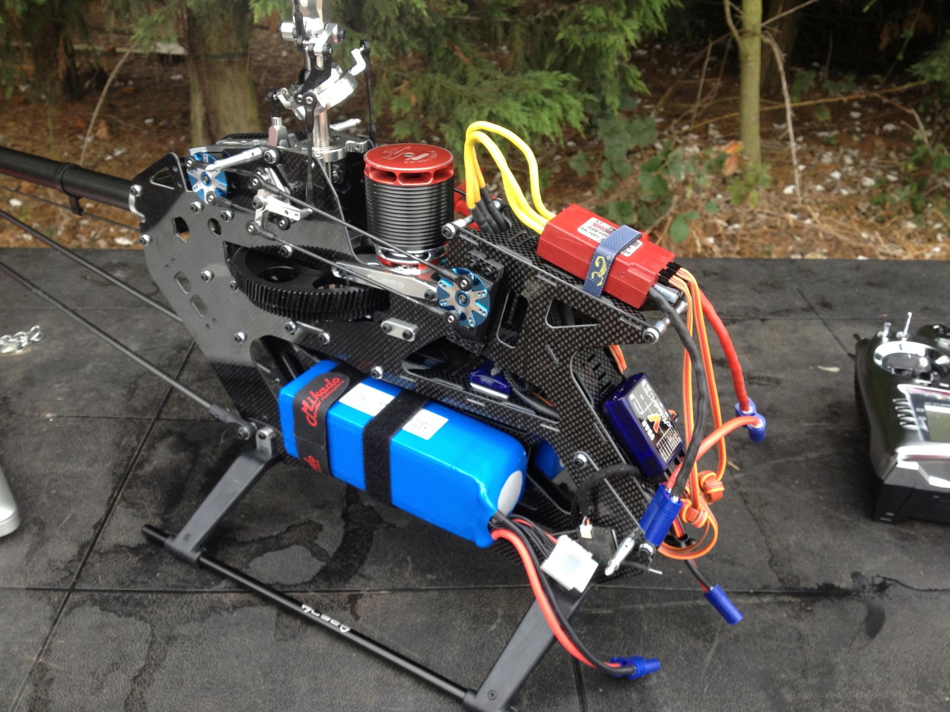

                  Yea cool, I left mine a little tight and they seem great now after them 3 flights. I forgot to do the tail one. Did it after the maiden as the tail seemed to respond with a notchyness but luckily I took it with me and done them at the field so schweeet
                  Ive just asked on HF for some pics on how they got there Vbars mounted. I think although it appears to be very exposed its actually a decent spot. Its solid around it so I think will fare well in a crash, maybe not as goo as where you got it but it will be okay
                  • #54
                    Had a tidy up at the front there.
                    Ross, you can mount the Vbar under the gyro tray or under the ESC part so you can then have the sensor up front
