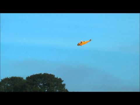

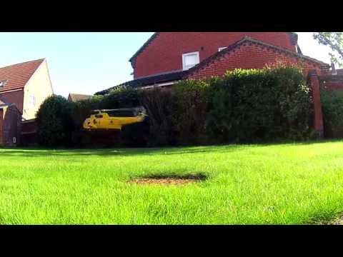

yep , the heli was jolly well liked at the fieldOriginally posted by sparts View PostNice,couldn't quite make out what the commentary was though.Something about being something awesome :-)
it actually sounds better in real life too , i`ve now got full throw at the back , and i am now gonna remove the mechanics to fit the new normal flybarless head n shaft . i`ll put together a tail motor battery box and i may see if i can do away with the tail control snake and fit a carbon rod or metal rod, will need to reposition the tail servo , but thats no hardship , i can normally have a full blown conversation whilst thrashing my little goblin about , but it was noted i didn`t say a word when i flew this today
anyway , enough from me , be back soon when shes up up n away , i not easily impressed , but am extremely pleased with the seaking
Seaking
That possibly explains why your little Goblin quite often looks a bit out of shape!! What do you think to the new field Ady?Originally posted by ady View Posti can normally have a full blown conversation whilst thrashing my little goblin about , but it was noted i didn`t say a word when i flew this today
