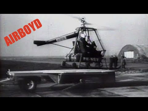

    Interesting, that.
    Wasn't there a heli (Russian maybe) that had Ram-jets on the tips, and no main motor to drive the rotor? Always seemed like a nice idea - really simple mechanically. Could even use centrifugal force as your fuel pump - sort of self regulating too!
    Anyone fancy a couple of small pulse jets on the tips of a 700 for starters? Could be a lot of fun. Would look good in the dark!

            Interesting comment in the vid of the Fairey Rotodyne..."for landing the tip jets are re-lit".
            What did it do in normal forward flight? Autorotate like a gyro-copter-thingy?
            What were the tip jets? Ramjets?
            Anyway, I want one!

              A great design and I can't understand why it never took off (excuse the pun). The only downside is you need an engine (or maybe a small turbine or even electric power) to get the ramjets up to operational speed, but the design is very simple, with no moving parts in the ramjets, so they're effectively like a gyrocopter on steroids

                  Yes,in forward flight it became an autogyro, like the Jamed Bond "Little Nellie"
                  IIRC, for take off and landing, compressed air from the twin turbo-props was fed down the rotor-blades to provide some thrust. When full vertical capabilities were needed, fuel was added and lit creating a sort of ram-jet - albeit one with a separate air supply.
                  It was when the tip jets were lit that it became too noisy to be practical. Wonderful idea, though. Shame it was never properly developed. I'm sure the noise issue could have been overcome.......

                    For this role the Hornet lacked what we now call 'stealth', as it could usually be heard by the enemy and the glowing engines could be seen from a long distance. Hiller once claimed 'the Hornet's sound range compares favourably with that of a conventional-powered helicopter' but without an intercom system the pilots had to scream at each other to communicate. The museum owning the only remaining flyable example of the 17 Hornets built received complaints from neighbours a mile and a half away when they last flew it.
                    The high drag of the ramjets meant the blade angle had to be set to a very negative angle when power was cut, and this led to the Hornet plummeting at 15mps during auto rotation. Only a very skilled pilot could arrest this descent just before the ground
