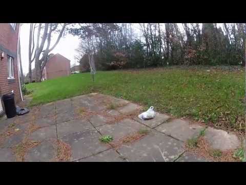

    I was doing some test flying behind the house and my Trex 450 exploded because the cheap ebay feathering shaft M2x6mm bolt snapped. I thought I could share my sadness..
