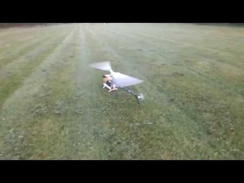

    Finally got my G4 flying and i love it Fly's much better than i had expected. All thought i am sure you can hear the bad noise every now and again, i am pretty sure its the bearings in the engine needing replaced. Hopefully will get that done this week, until then i don't think i will fly it anymore in case it causes any damage. This is my 3rd flight on this heli and my first nitro so it still needs a bit tuning to the engine and vbar but its close
    Also be sure to watch the video in HD or the quality is not that great

    Nice Conor was it as tight as it looks ?
      Thanks Yea it's a very small field, i cant believe how much bigger the camera makes it look. The big tree at the right i come close to a few times

                        Nice Connor, couldn't hear anything untoward maybe a bit rich on the top and mid but I wouldn't worry too much about it mate. The head and feel I think comes from the head design and even though there are bellcranks in there it feels very direct and precise. I use Vortex on mine and the 700n and e700 feel very different although the settings are similar.
                            Thanks Dave! I was thinking it was rich in the mid, but i fell pretty happy with it. If i do constant tic tocs its dose not seem to bog or or have any negative tendencies so i don't think i will adjust it. However the top i was thinking needed to be more rich, when i do big loops or sit on the high needle for a long period i feel like the heli starts to lose head speed and all most sounds like it will cut out. I was thinking that's it not getting enough fuel but i am not sure

                              It sounded slightly four strokey with a gurgling on the loop you done. I'll have a listen again, what engine is it Connor
