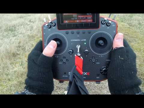

                              Sounds like your pitch and throttle curves are not well matched so that you have either too much negative or too much positive before the rotor is up to speed.
                              My recommendation is to never use a 'normal mode' curve. Just use flat line 'idle up' curves and start/stop the motor with throttle hold switch. This separates the collective control from throttle and means you dont get into any of these mis-matched curve difficulties. Spool-up drill then is to simply set the collective pitch at zero and release throttle hold... dead simple and fool-poof.
                              here's a video I did for my buddy showing how easy it is if you use this setup:
