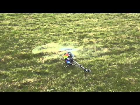

                  I disagree.. i dont think you should see any consistent left or back drift on a properly setup heli. Helis might not be stable as in automatically 'self-righting', but even so it you put them in a perfect hover on a calm day they should pretty much stay in the orientation and position you put them 'hands off'. Sure after several seconds they will start to gradually drift, but the drift direction should be random. If it's drifting in the same direction consistently then that indicates something not quite right.
                  Dont believe me?... here's my 7HV videos earlier today (flying with a 'cheapo' Kbar):
