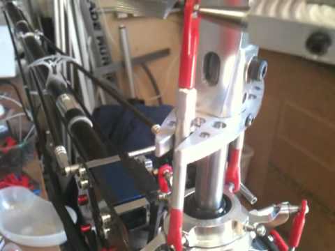

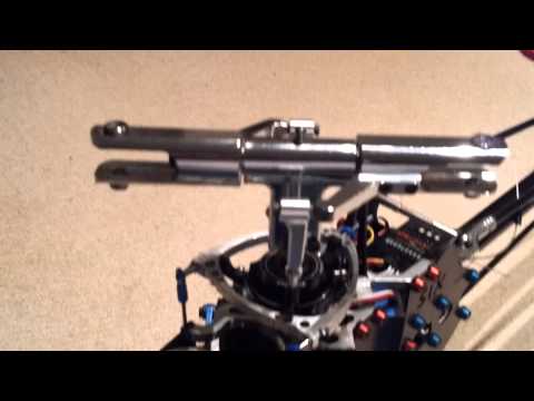

before ya start throwing big words like "DFC PAH!" around you should know DFC has got nothing to do with lowering the head....the lowered head is a by product of the DFC "DIRECT FLIGHT CONTROL" arms that remove the anti rotation swash link arms you can change the length of the main shaft by adjusting the lenght of the Down links as I have in many of my own designs here is a photo of a real DFC head ....DFC cleans up the head from all that clutter and there are many ways to do it not just Aligns copyed way...
and a vid of one of my 1000's head design

other designers have the same principal with various length main shafts and various CG positions but the down link to the swash remains the same design ..all it does is stops the swash from rotating and removing the swash arm links and connection to the main shaft
the bigger picture you speak of isnt true..there are large scale helis out there with long DFC connections that dont use a high CG or need to make the shaft more ridgid they just use stronger thicker main shafts..its not just aplicable to stickbanging 3D heli setups

(BTW - in that second image /video down (entitled 'metal pushrods') the head you're showing with the custom made guides is not a DFC head, you have conventional (omnidirectional) links on the grips. )Last edited by trillian; 22-02-2013, 04:53 PM.Kasama, Minicopter, Henseleit, JR, Shape, Beam

I dont seem to be saying anything..I am saying its just a link bewtween the Bladegrip arm and the swash removing the clutter of the other systems ,there is no advantage in flight controll at all,just cleans up slop if its a good system with good bearings in the downlinks
and the acronym of DFC are just some letters that some bloke sucked out his thumb while ripping the design off and had to think of a name, its just a sales pitch name its actually a Direct Swash Connection so should have been DSC if they paid attention to the simplest way of using english, "Direct Flight Control!" WTF is that?
BTW yes you are correct is not a DFC head I never said it was...what I did say was (DFC cleans up the head from all that clutter and there are many ways to do it not just Aligns copyed way..) but its still a connection from the bladegrip arms to the swash without a swash lock driver ..the arms only move up and down in the pitch range giving it the same direction use as a ALIGN DFC down link and the swash moves the same as it would in all heli deisgns..
