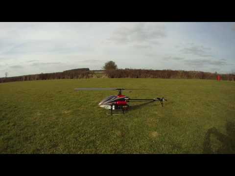

                              Here's my Bergen... Turn the volume up...
