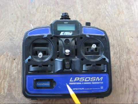

    I have binded my blade 120 sr to my spektrum lp5dsm and i seem to have a problem. When I move the right stick to the right the helicopter goes the opposite direction, This happens with every direction I move the stick. The throttle side of things is fine there is no problem there but it seems like the right stick has a problem.
    Please help!

    welcome to the forum. It sounds like your dip switches are reversed(under the cover on the bottom left) here is a little vid to help you
    LP5DSM Dip Switchs - YouTube
