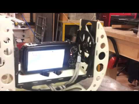

    Just did a little job for my uncle who is a wild life photographer and wanted remote control to his camera..so building him a gimble and will fit this system to it...he can also use the TX to learn to fly rc aircraft so a bonus..got the Tx from a RCHA member a few weeks ago and this is the result of half a days work...Im goin to do the same for my Gimble setups as the sticks on the second TX that controls the gimble auto centre so not so usefull as you have to hold the sticks in a certain postition if you dont have a gyro system...My innovation just needs you to turn the knobs and when you find your shot ..take it!...

    The Controller will be operating This Gimbal
    Yea Baby!

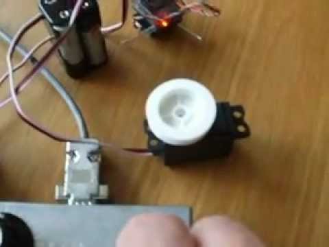

      Looks cool - but uhm.. how do you control the zoom on the SLR? zoom is manual.
        Thanx
        yes it is
        so all you do is fit a 360 degree servo on a baseplate under the zoom wheel and fit an o'ring and presto you have Zoom!
        if you take a close look you will see a little groove that the o'ring can run in...most lenses have this groove its enough to keep the o'ring tracked doesnt have to all that tight as its rubber on rubber seen this done on crane camera gimbals in the movie/advertising industry where I worked as A Video Takoff operator..its a cam that fits into the eyepiece of a million dollar movie cam that uses stock film..so the vid is recorded and the producer can see if the shot is in the can before it gets sent for developing

          I'd really love to see the zoom feature and how you've done it. Also do you think focus pulling could be done in a similar fashion?

            will do thats my next job on the table this afternoon/evening should be done by the morning..
            most definatly if you have a calibration scale and it matches up with whats on the focus ring i dont see why not....

              Cheers. Look forward to it. One more thing 360 degree servos - where from or do you just file out the stop on a normal one?

                I got the 360 servos from HK....
                HobbyKing R/C Hobby Store : Sail Winch Servo 13kg / 0.7sec (360deg) / 55g
                nice tourque too

                        here is my uncle,s uploaded demo of the servos working with his breakout box...

                              Xygaz ... if you want to motordrive a ZOOM lens on an SLR you need something like this...
                              Canon KH19x6.7 KAS SY14 19x HD Remote Motor Drive Zoom Lens w/ PMW-EX3 Adapter | eBay
                              DSLR Cams cant be that "Proffesssional" then boohooo I want my money back!!!!! all 5 grands of it for all 3 maybe they will just change out the lenses for those motordrive ones that are available for a small dna sample of my entire familys blood...oh well will have to just live with the HD Vids I get from my SLR still cam then.My 10 dollar servo and o'ring does excactly the same job no worries
