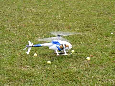

            The Innovator is a great heli for a novice, it got me flying easily in early days and I loved it right from the word go.
            I did however change the foam blades for wood at a pretty early stage, upped the head speed and modded the curves to my taste within a couple of flights as I found the stock out of the box set up just too stodgy.
            Heres a vid of one of my very early flights
            In the second half of this more recent vid you'll see the same heli but now fitted with the TT GF fuselage Fast forward to about 2:28
            Graham
            Phoenix, DX6i.
            x2
