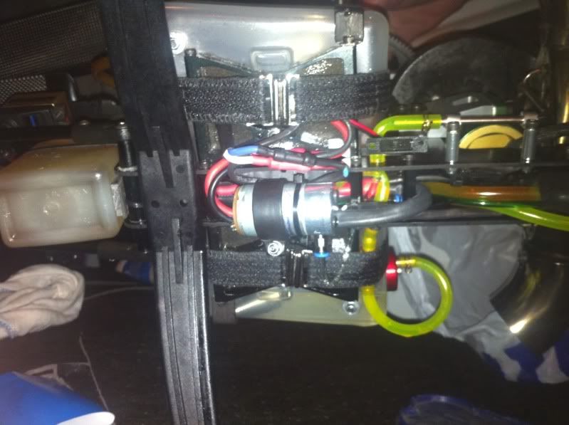

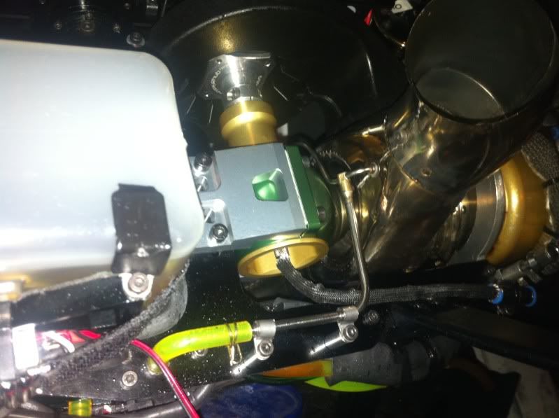

    After lot's of reasearch and phone calls, we settled on a wren turbine fuel pump as the smoke oil pump, powered by a (massively overkill!) 25a brushed speed controller. The physical instalation was a bit of a challenge, but not too bad. The pump was mounted in the middle of the frames underneath the tanks, and the esc hidden under a tank strap. The pump feeds the OptiSmoke in to a stainless steel tube in to each side of the turbine exhaust housing, which just sprays the fluid directly on to the inside walls of the exhaust.
    We tested it under the cover of darkness (as no-one at the club knew we were working on it and wanted to debut it as a surprise at todays bonfire/BBQ/Night flying do) just to test the thoery actually worked, which it did, very very well! Today we flew it, and after a slight bit of fiddling with the pump rate, we had it working a treat Anyway, enough waffle, see the video below which says it all
