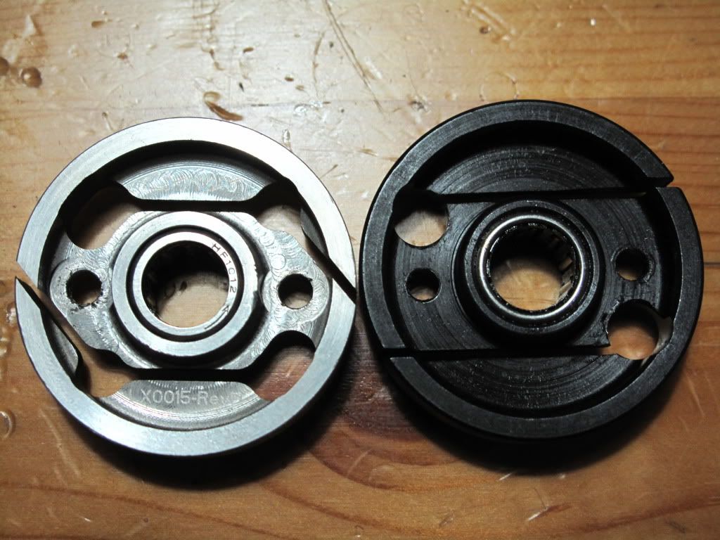

Tank full, Tx on RX on, Starter motor in and it spins nice and fast but not turning the motor! Now i know the starter is fine as i used it on the Srimok, the only thing changed is the clutch.
Going back a week!
Like most people i've had the problem with the 600 LE's clutch.
it works but comes in very late, close to the point where the governor comes in it starts to bite, then you have to be care full to let it pick up speed before the gov takes over.
Well last week i ordered from Fastlads a new upgrade clutch from Lynx, and yesterday evening fitted it into the heli. about an hours job, motor out and back in.....
So back to today.

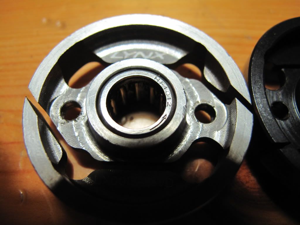

Motor out again clutch out and then i see the problem! the Sprag clutch (One-way bearing) for the starter is fitted by Lynx the wrong way round
you can see the new sliver and original align black!
In this photo you can see the arrow indicating direction of rotation.
Well they are Locktite'd in on a interference fit, so hard to get out without damaging them.
Will have to make a tool tomorrow at work to press out the bearing and re-fit the right way round.
I don't know if this is a one off from Lynx or a whole batch from them, But i'll be contacting Fastlads so they can check there stock.
