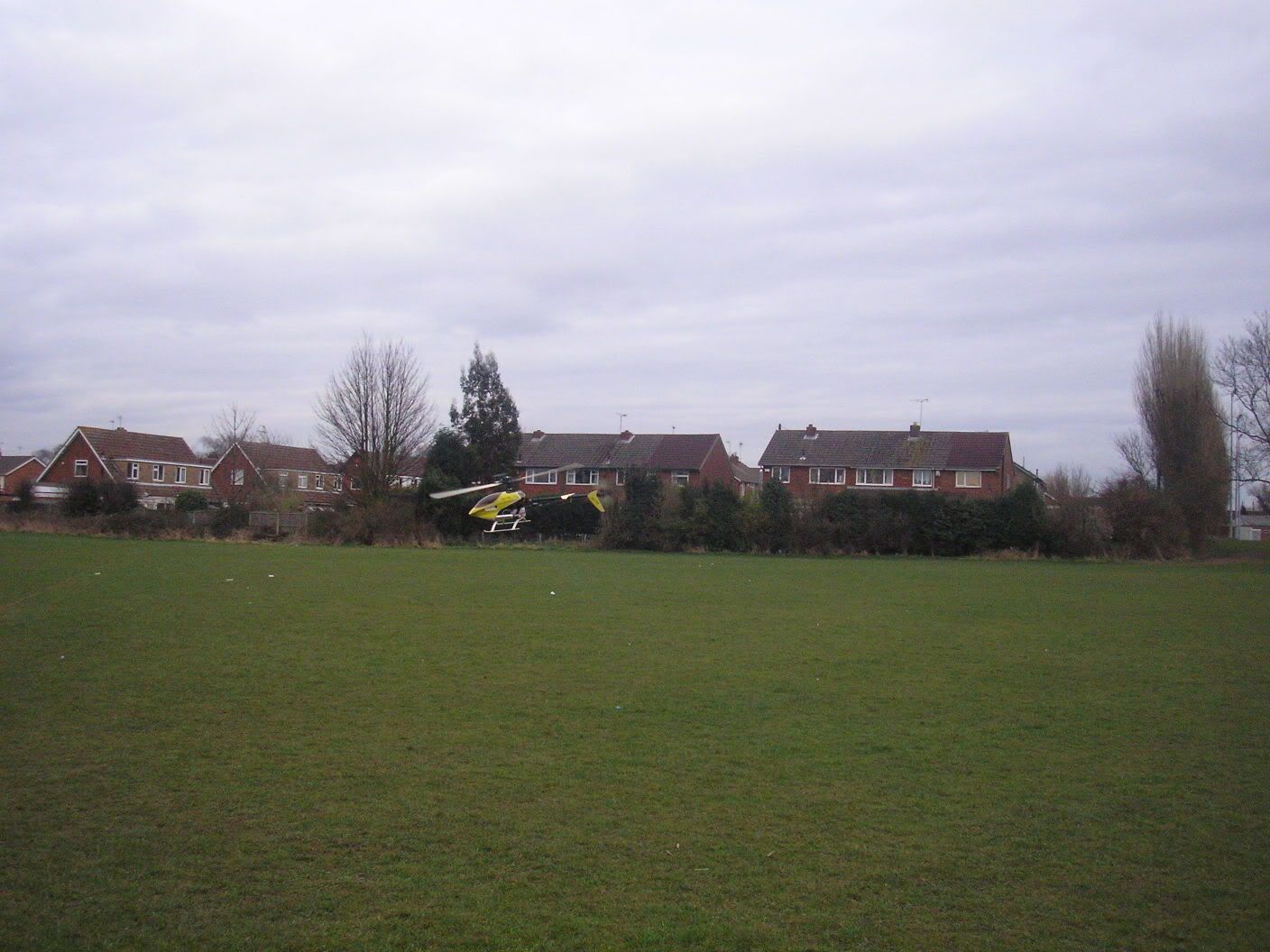

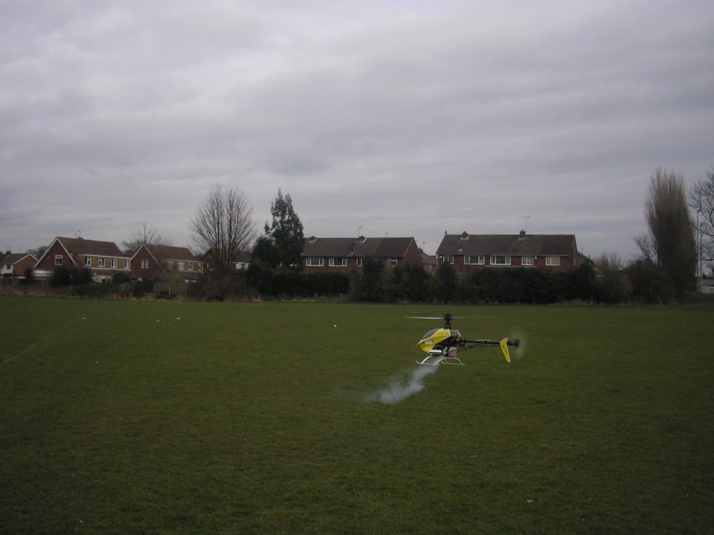

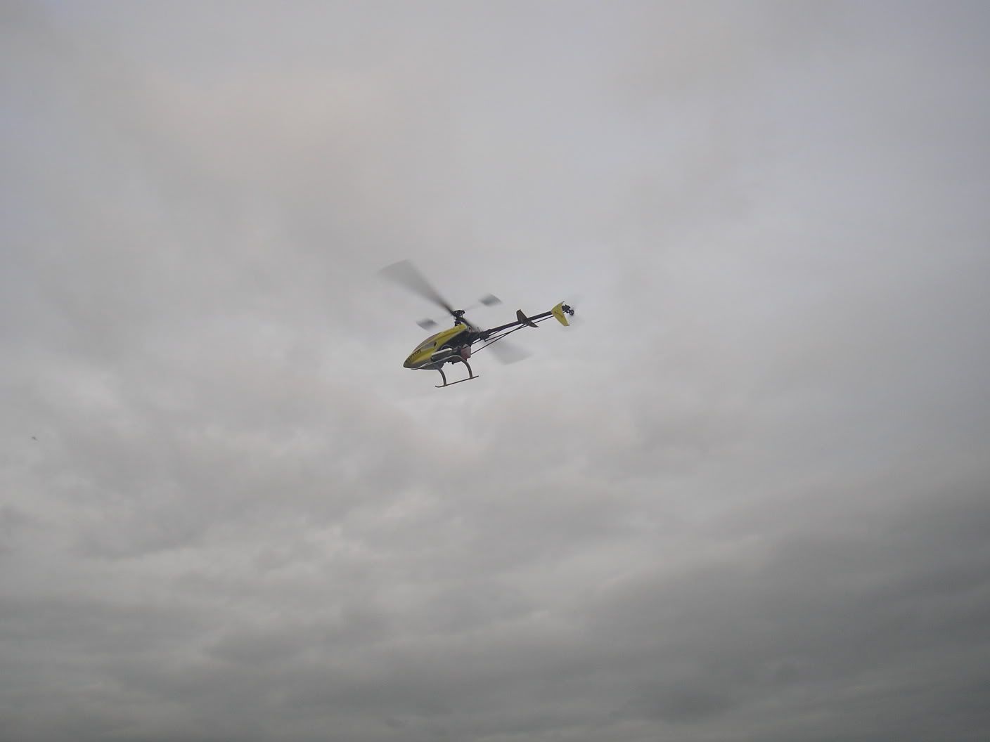

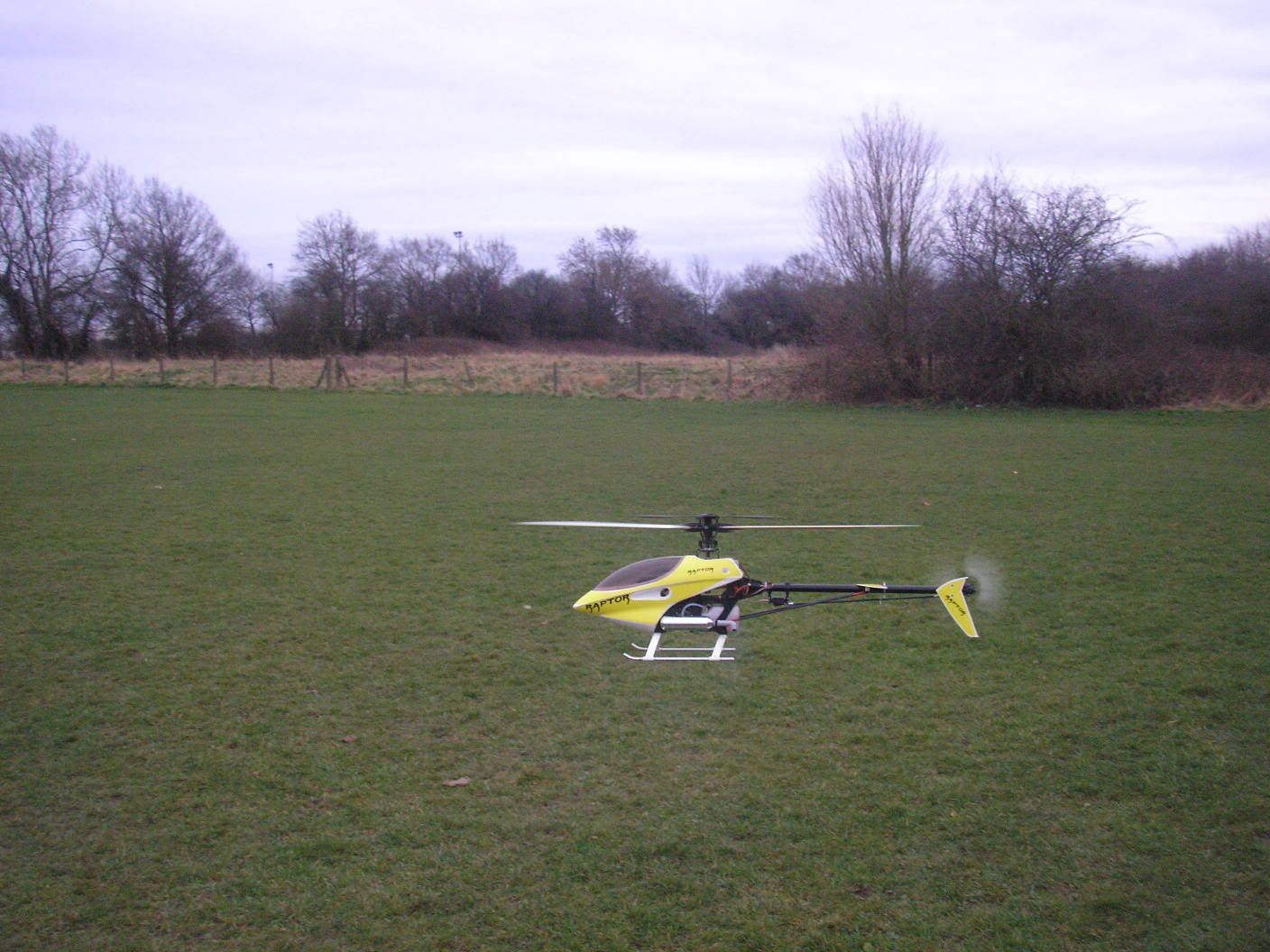

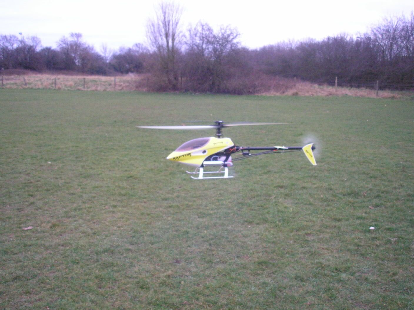

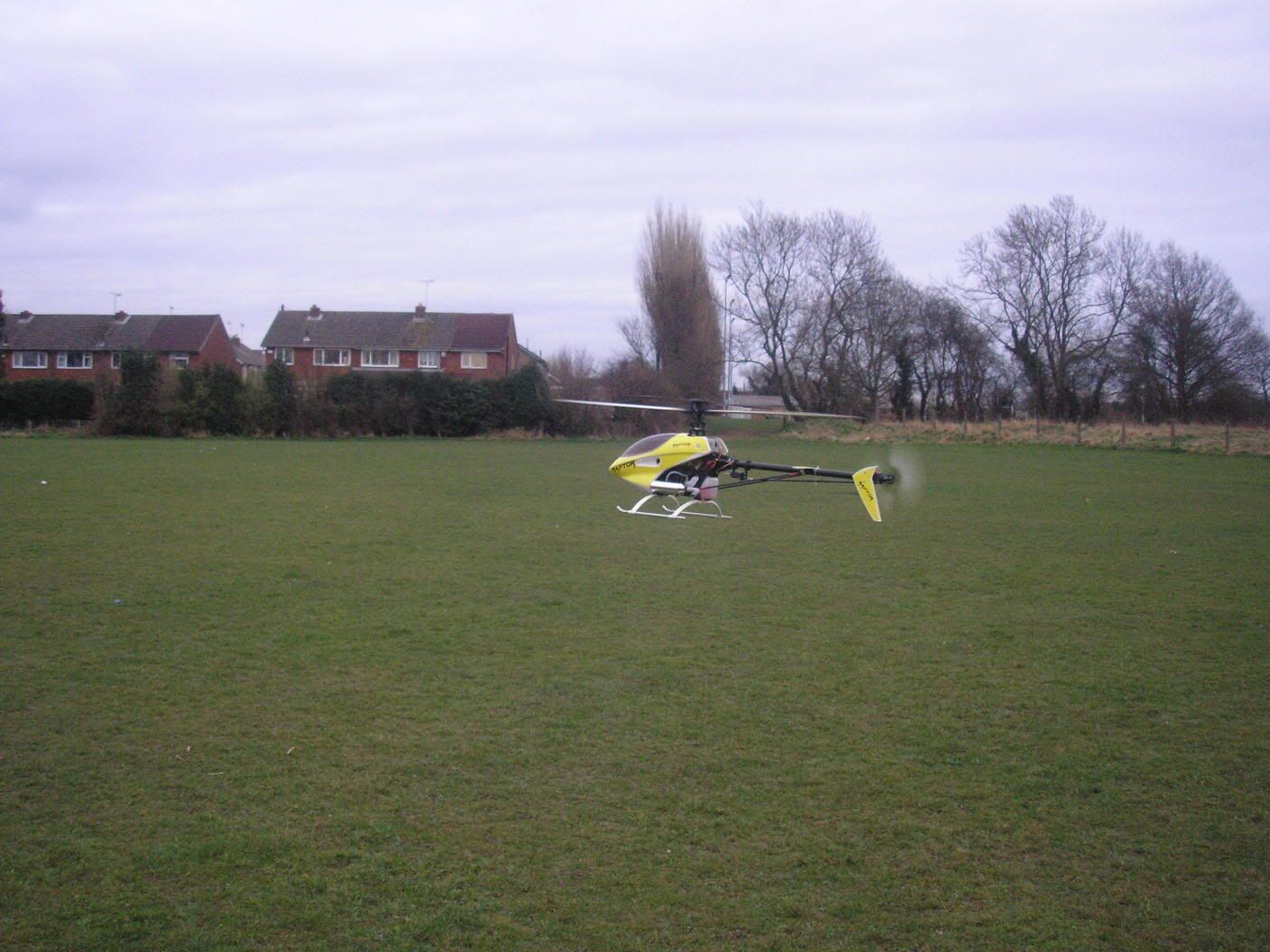

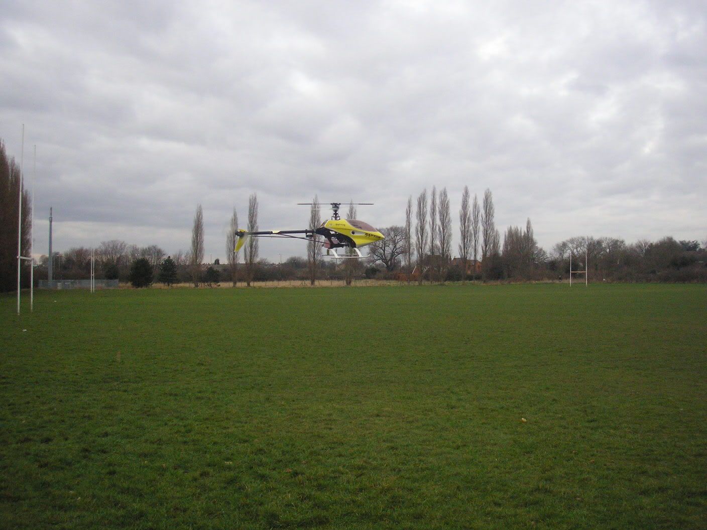

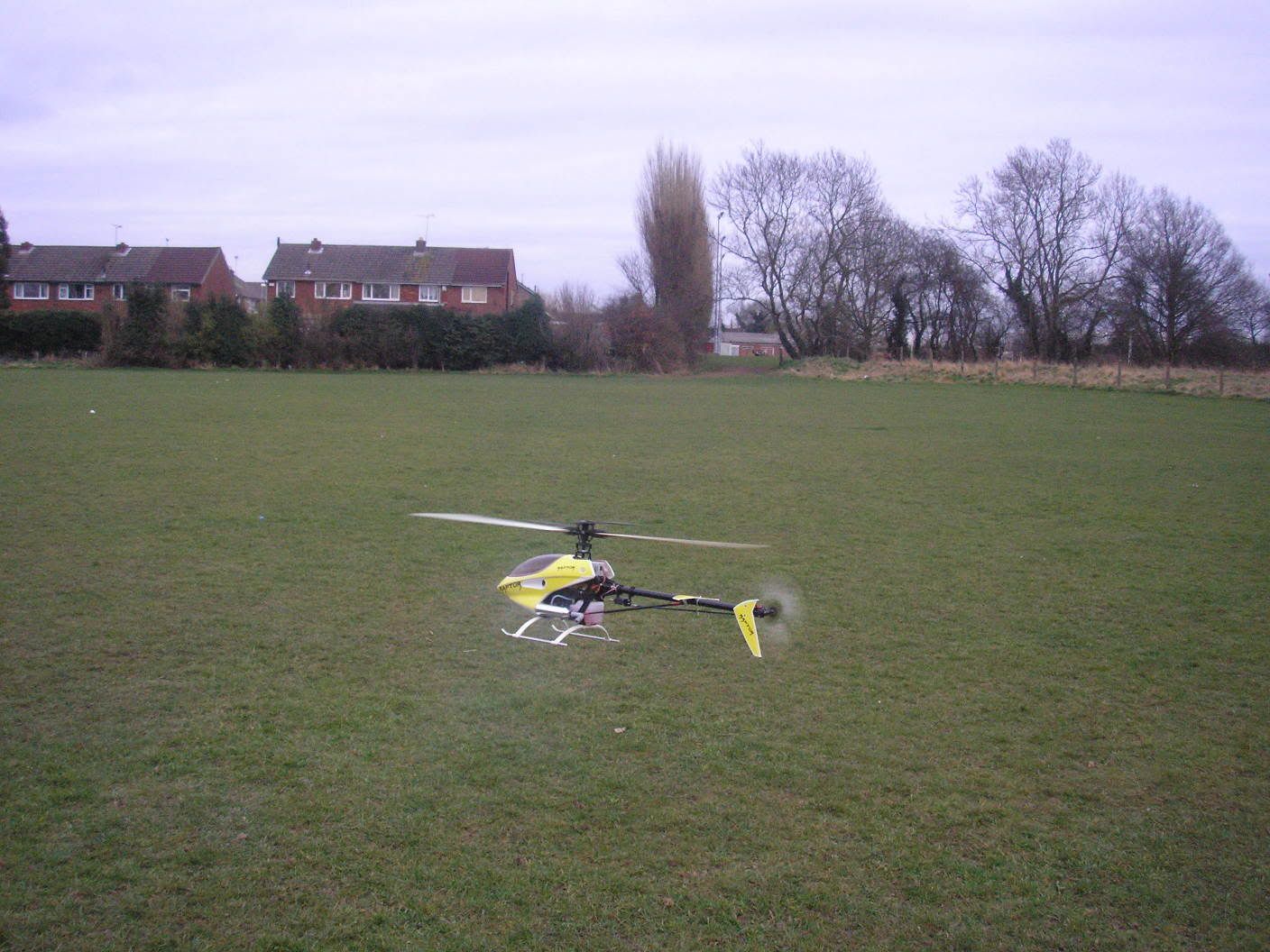

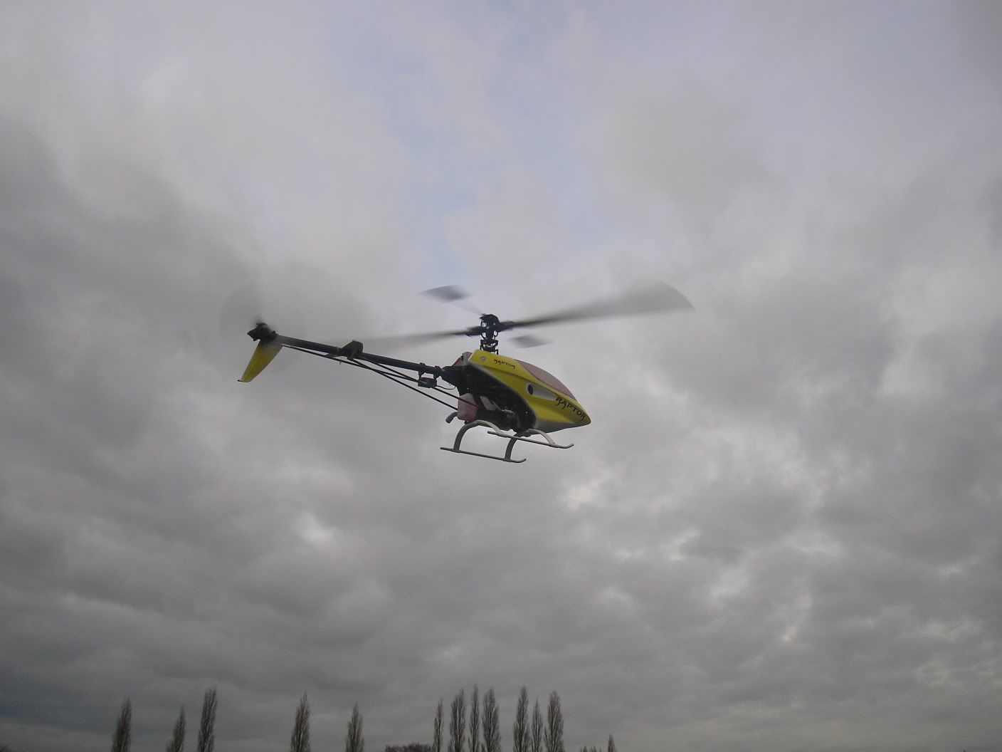

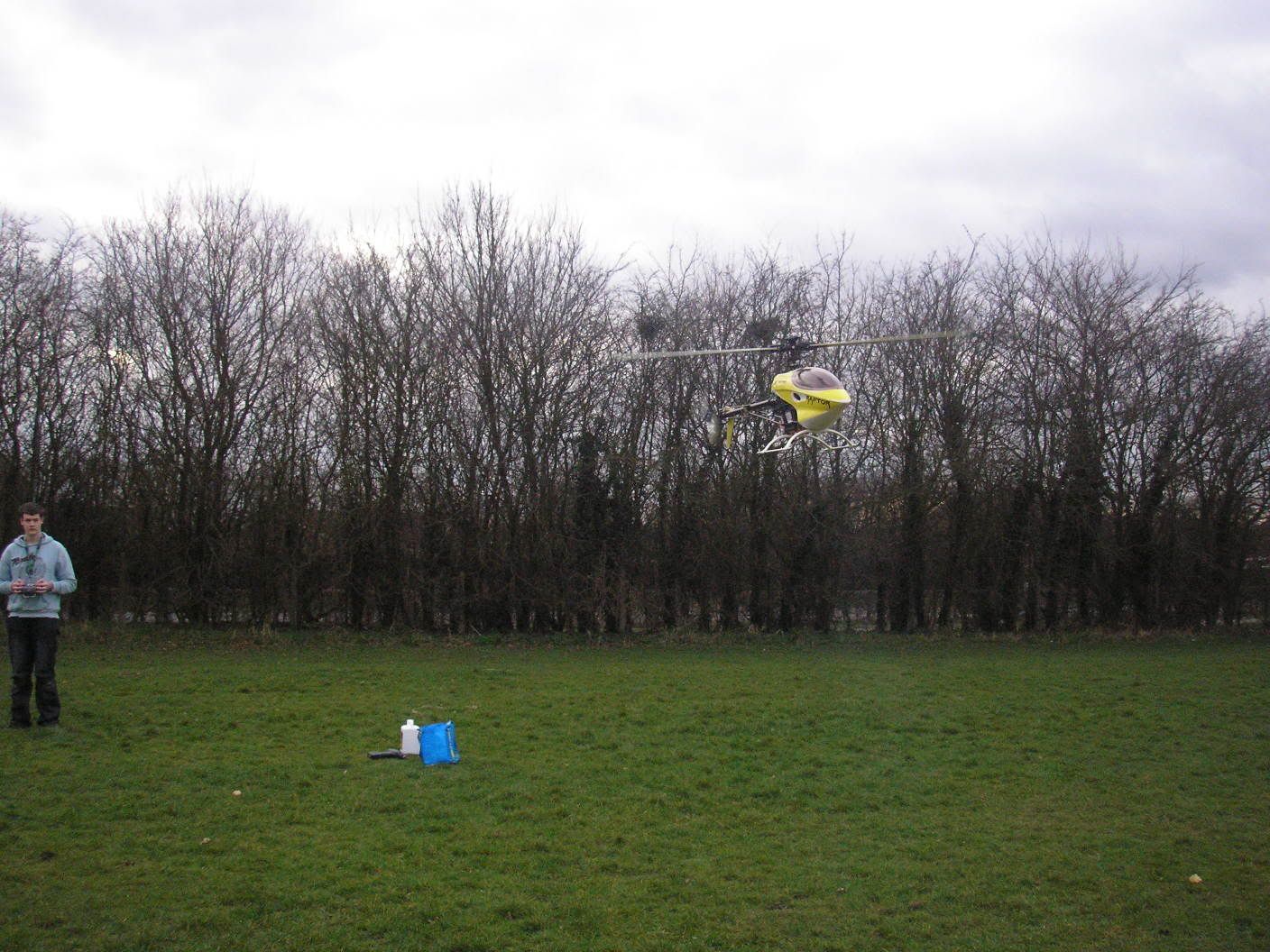

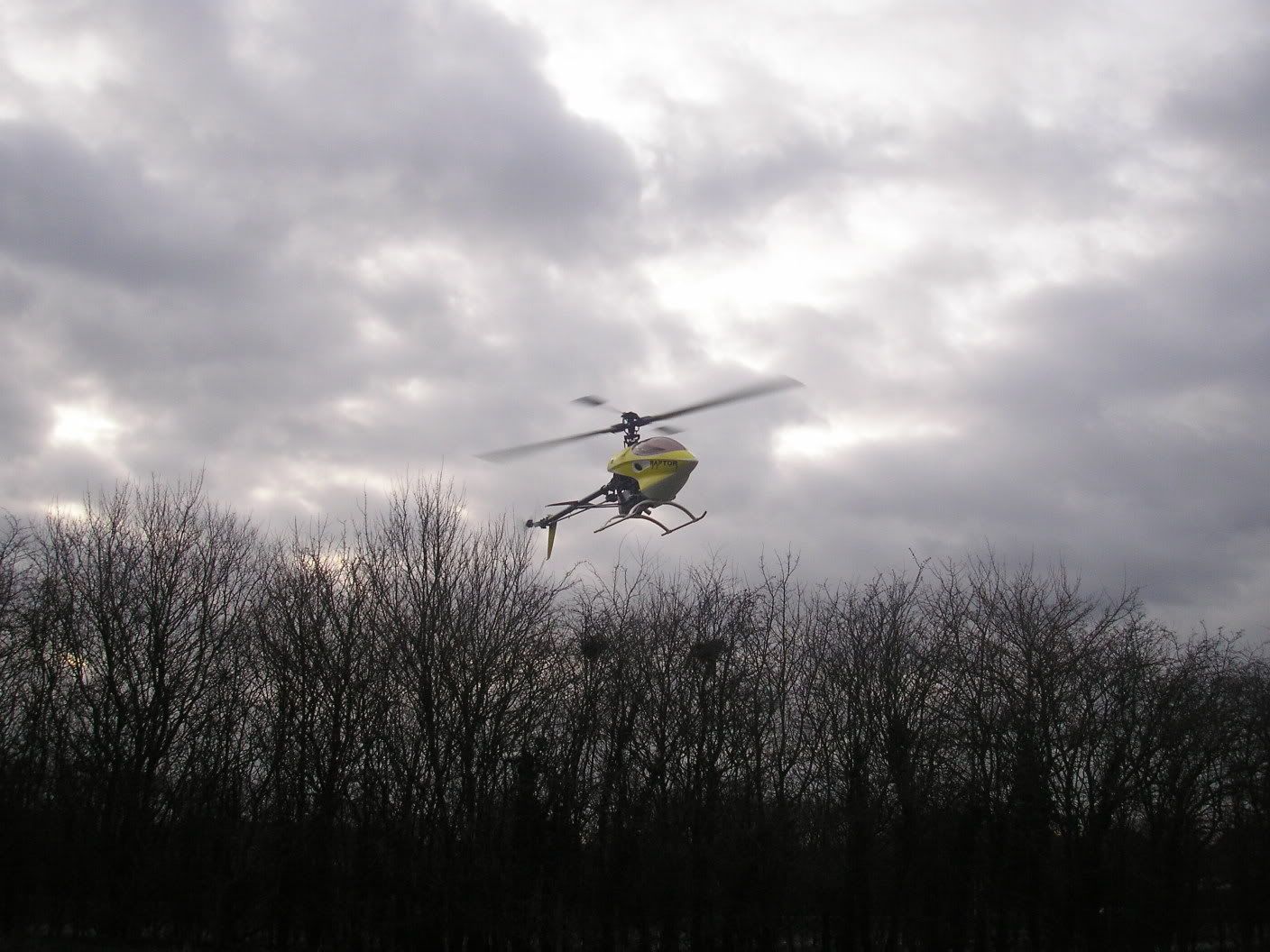

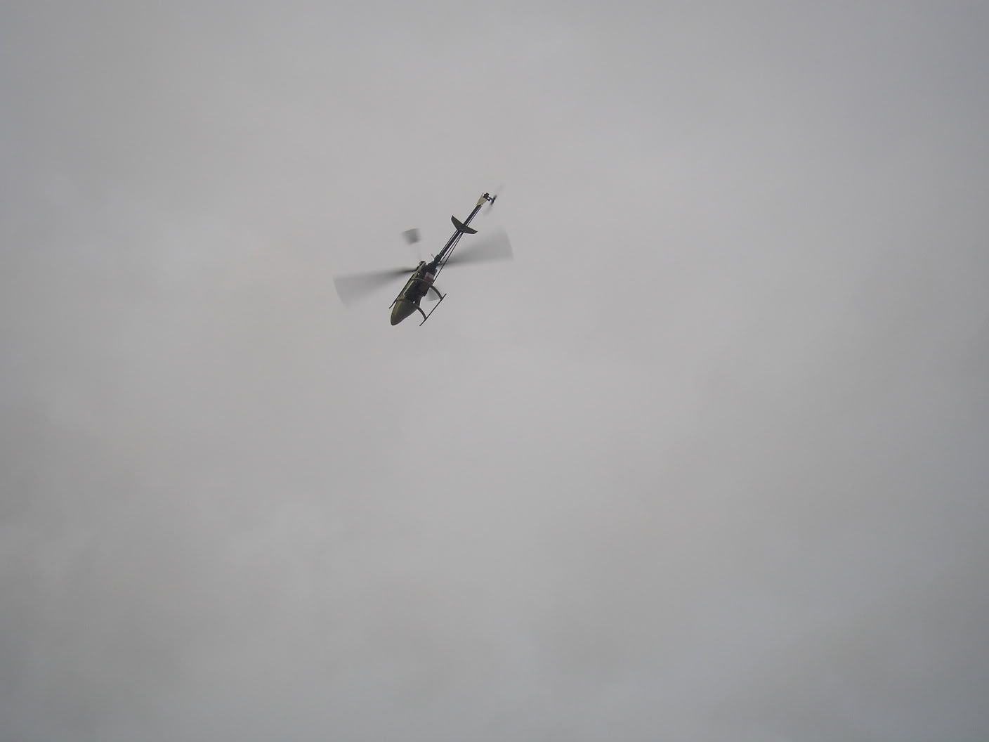

    Not Bleeding happy, but got some good digi cam shots non the less,

    Pictures

    post your good pics mate

      Uploaded Pics check first post

        good pics cal and use epoxy instead of loctite ;0)
