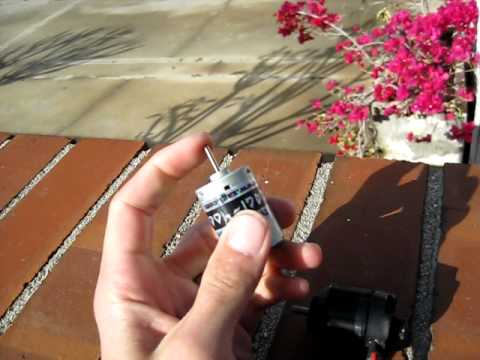

                  Hi , so the next question is whats the difference between out and in motors please. I have heard this about Blade motor bearings before so maybe will upgrade. My old mate has just got a motor from HK , along with the heli an fixings are only 18 instead of 25 mm apart so a bit of a minefield isn't it
                      Virtually all heli motors outside of 'toy grade' helis with brushed motors are outrunners. You can get brushless inrunners but you wont normally find them on helis, so you don't really need to worry about the difference.
                      But FWIW
                      • Inrunners have the magnets on the inside and the windings on the outside. The magnets rotate inside diving a shaft and the outer part is fixed.
                      • Outrunners are the other way around, the inner iron core with the windings is fixed and the magnets are glued in a steel 'flux ring' that spins around the core, so the outer part of the motor that you can see spins.
