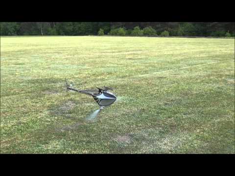

                    Here's Timo, the low head speed master!
                    Kasama UK | Bavarian Demon

                          Now that is what i'm looking at... I could watch this all day long and never get bored of it.
