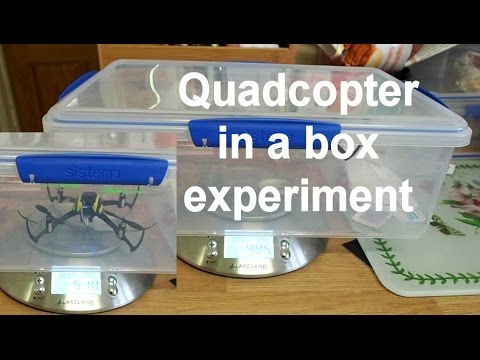

    See this Youtube Vid which shows a Quad copter flying inside a sealed container,
    When the quad lifts up the weight goes down to that of the container!
    Who feels clever this morning & can explain this?

      Hmmmm, not sure what's going on there. 'Common sense' would be no change in the weight because the quad is still inside the box whether it is supported by a column of air or something solid.

        well any air deflected down is getting pushed around back to the top of the box anyway. so i imagine the net result is 0.

          People expect the mass of air being pushed down to equal weight of heli so say scales should not change.
          Heli doesn't just push itself up by blowing air mass down, it pulls itself up due to pressure difference over blades.
          So force of air hitting box does not equal weight of heli.

              I expect the quad to be exerting a downward force equal to it's weight in the hover: whether that is due to pressure differentials, air blown down etc doesn't matter.. to lift itself up there has to be a force down - so something is screwy here such as a servo in the scales lifting from inside?

                  With a aircraft or a bird flying inside a container, the weight does not change. All that has changed is that the pressure of the air has been redistributed to support the object. From a weight standpoint it makes no difference, so there's something wrong with this Youtube container thing. I would expect the scale to move at first simply because the weight inside the container is shifting around, but if the quad would stay put long enough I would expect the scale to get back to where it was before (the exception being that if the weight of the quad is way over to one side or the other it could throw off the scale's reading because the platform on the scale may sense unevenly, like if you put a weight at the edge rather than in the middle.)

                      Tell you what, let me grab a container and I'll try the same thing with my little hubsan x4!

                        Well I have been scratching my head & I have watched it 3 times.
                        The thing I notice is that the box is wide but not very high,
                        Thinking about the down wash (imagine the air is made up of particles) they will hit the bottom of the box in theory with an equal force to the weight if the quad. But then bounce upward & then hit the top of the box which is very low. Some of the momentum will be imparted downwards, but some will be left to impact the top of the box.
                        If you are going to try this experiment, try it with a box that is bigger (taller) relative to the size of the quad if you can?

                          Here is your answer!
                          https://www.youtube.com/watch?v=dCY9...Y6JX924n7UfOcw
                          Futaba 14sg
                            Nice, that answers that then!
                            I still wonder what was going on in that other video though.
                            One difference here is that the first Vid was a plastic box with flexible (springy) sidewalls, while a metal container isn't.
