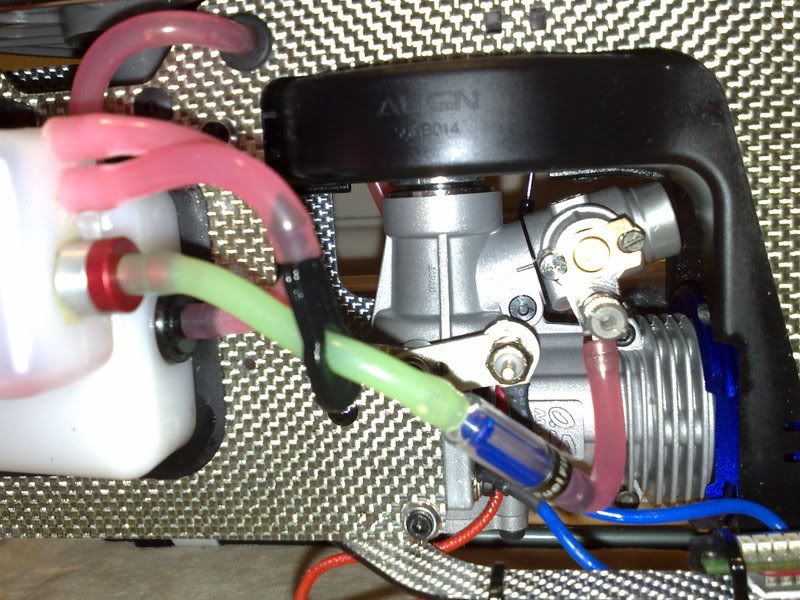

    if i start my os 50h and run a tank it runs fine if i then cut ,it floods so when i go to restart its solid locked up.
    we also run the heli dry and this happend again can this be due to the idle needle settings?
    its as if you get it running plug out etc then its fine, but to get it goin every time after were having to take the plug out un flood the engine with the fuel line closed off then put the glow plug on turn it over then open the fuel line.
    the usual things have been checked the throttle is fully closed so how does the fuel reach the cylinder?
    we also removed the engine back plate to find fuel in there.
    any suggestions would be great

        Just to check the obvious - you are not allowing some overflow when filling to go into the silencer via the pressure line are you?
        It is possible for fule to syphon down the pressureline into the silencer, but not normally unless you have fitted a uniflow setup (then you need to block the pressuse line when you are not running).
          Being a new engine, you probably had it running quite rich to bed it in nicely?
          how much has it been leaned off from then?
          What are your needles settings - base needle points to what hour of the clock when the heli is level?
          How many turns and clicks out from fully closed is the base needle?
          What muffler are you using?
          What fuel are you using?
          Any fuel filters in the system, if so what type and where?

                  The base needle can adjust through 180 degrees and comes preset by the factory in the middle. Yours looks just a fraction richer (turned anti-clockwise) than factory default?
                  If the engine has been running quite rich for a while, it's possible that the muffler has a gunk buildup in it (unburnt fuel and excess oil etc) which can seep back into the engine and lock it up every time - it's not liquid enough to pour out easily (like fuel will) but taking the muffler off and washing it out will ensure this is not the issue. I saw exactly this issue on a fellow club members heli last weekend - possibility?
                  Otherwise, as has been said, make sure you aren't overfilling the tank and forcing fuel down the back pressure pipe.
                  I guess you detatch the pipe frmo the filter to fill it up? In which case, you can't be flooding the carb accidentally when filling

                      Hi Timmy I reckon Robs on the money with the answer to your problem..
                      I have come across this problem a couple times and it was a combination of things. Very rich set engines (running in) Castor based fuel seem more prone to this hapenning. Sometimes tilting and giving the heli a good shake is enough to clear it otherwise you need to flush the Exhaust out.
                      Also make sure you clip your fuel line as soon as the engine is stopped as any remaining exhaust pressure in the tank will still force fuel into the carb untill it dissapates.
                      Another way it can occur is sitting/starting/storing the Heli on an un-even surface where the Exhuast port is tilted slightly allowing burnt fuel to dribble back into the engine causing it to Hydro lock. Turning the start coupling by hand to TDC will prevent it dribbling back in.
                      Another good tip is to tilt the the Heli towards the Exhaust before trying to turn it over and only unclip the fuel line once your ready to fire up and the Glow is on.
                      Hope that helps you Brian
                        Tell you what Brian your right on the money there..
                        We park on the roadside and stand our helis just through the gate and yes!!!!!
                        On a really steepish bank to work on them and then walk down to the flatter flying area to fly..
                        The angle we were filling the heli up was muffler on the top side and I'll bet that's the answer..
                        Thanks mate. Timmy will be well chuffed when he reads this.
                        Jackpot I believe there mate thank you..
                          I clip my fuel line to cut the engine to help prevent this happening at all

                            One more to add to the extensive list above...LOL...is when fuelling make sure the feed side to the carb is clamped/sealed properly or even disconnected at the carb side.
                            The fuel tubing Align supplies in the kit has a thick/stiffer wall and my little clamp struggles to seal it 100%.. could even be this simple so worth checking it out.

                              Hi Tim,
                              That is too rich for the hyper even when running in, bearing in mind that the factory rich setting is 1.5 turns out.
                              At most, I wouldn't go any further than 2-3 clicks out from the factory 1.5 turns and I would only do that for the first 1-2 tanks at most. I would then adjust it back to 1.5 for a couple of tanks. Rich is good for running in but having it too rich is counter productive and will not help the running in process. Get the main back to 1.5 tuns out and ensure the idle screw is parallel with the carb opening.
                              Once the engine has been run in and leaned to its optimum setting (usually 1 1/4 to 1 1/3 turns for me), it will not flood as easily. However, in the meantime I would suggest not using the throttle kill switch. Instead, use the fuel line clamp to shut of the fuel supply to carb. This will help prevent the flooding for when you start up again. I now do this with all my 90 size machines by default.
                              If you still encounter problems after this then remove the fuel line from the carb before filling up and check that the fuel line clamp is doing its job.
