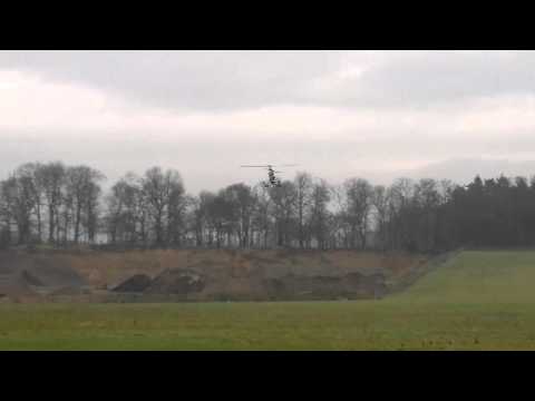

        i`ve built a tandem or two . i actually enjoy doing stuff like that
        Seaking
          [QUOTE=ady;1057356]i`ve built a tandem or two . i actually enjoy doing stuff like that .
          Thanks for the video. How did you get the two sets of main blades to overlap like that? I assume that they must be geared together via the interconnecting boom(s)?

              This is soooo cool - more info. please.

                Me too, I find it quite amazing!

                      t-rex 550 tandem , now with circuits video - Page 2
                      lots of info here n pics too , thanks for your kind words
                      Seaking
                            Wow..... Build a Quad version ... lol. Very impressive.
                              Thanks for the additional links. I see now that one rotor head is above the other so they can't touch, if I had known more about the Chinook I should have realised Doh!
                              But now I want a small one for the garden, don't suppose I shall do it though.
