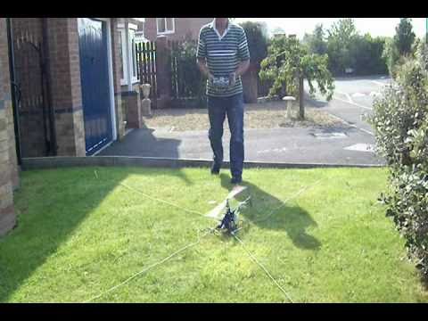

    Has anyone tried the hover-eze setup that Ian Turner uses to train students on chopperaddicts?
    looks like a good training aid

    that training aid is possibly one of the worst ideas I have ever witnessed.
    The undercarriage is designed to hold the helicopter off the ground not to take the pounding that full collective can give. it is only a matter of time until the U/C gets ripped off the bottom of the heli and it shoots off in whatever direction you happen to be holding on at the time.
    the concept is ok but I'd like to see some proper connections to the heli frames not relying on four 2mm self tapper screws. in the case of the trex 450 pro there are only 2 screws holding the uc on.
    get some training undercarriage, and find the local club, or a big car park and skate the thing around on the skids until you have a feeling for it. flying a 450 in a 6m by 5m box is pointless if it is tied down so it cant move.

    sorry to put a downer on something I am sure I will be flamed for saying someone's idea is crap but that one really is in my opinion.
    an mcpx over grass is almost indestructible. this could be a way forward if you are intimidated by the 300, but in a sensible sized space the 300 should be fine if it is set up correctly.
      that training idea looks like an accident waiting to happen imo

        I had second thoughts about the hover eze training thing anyway, your right in the fact that uc's are usually pretty flimsy plastic and it wouldn't take much for something to go wrong, I ve gone the normal route and got training gear and just heaps of practice on the sim, the problem with the sim is that I cant discipline myself not to stick with hovering in all orientations, after 5 mins I'm buzzing about flying inverted and practicing tic tocs and hurricanes
        In the real world I ve had a few good hovers 40-50 secs stable, but stripped the main gear on Sat after a little bounce off the ground and training gear pulled out of the hub and flipped into the blades causing a little crash.

                            Welcome Ant, the hover easy or whatever looks like it's more bother than it's worth. Stick to what you are doing buy a sim and enjoy untethered hovers
