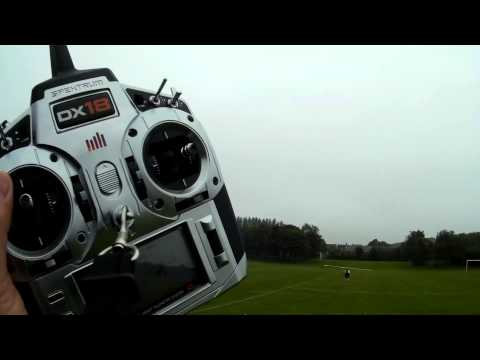

                            yep, bigger is always easier. My 7HV:
