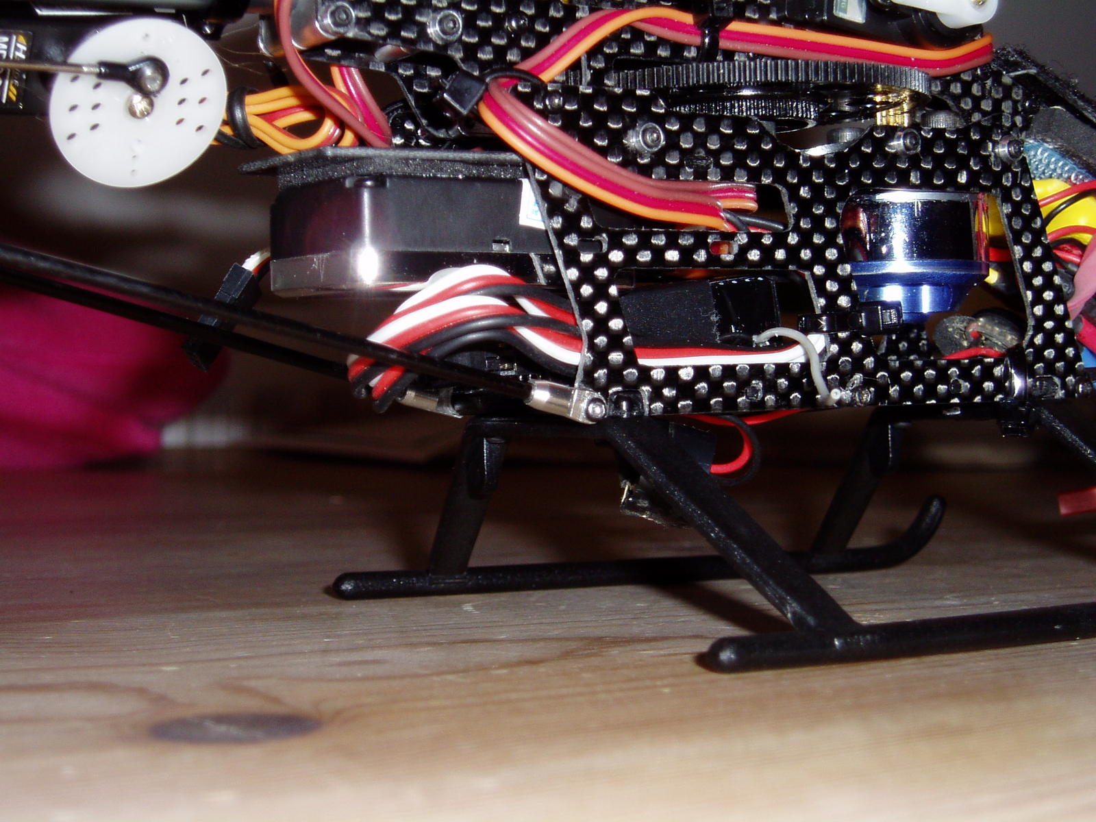

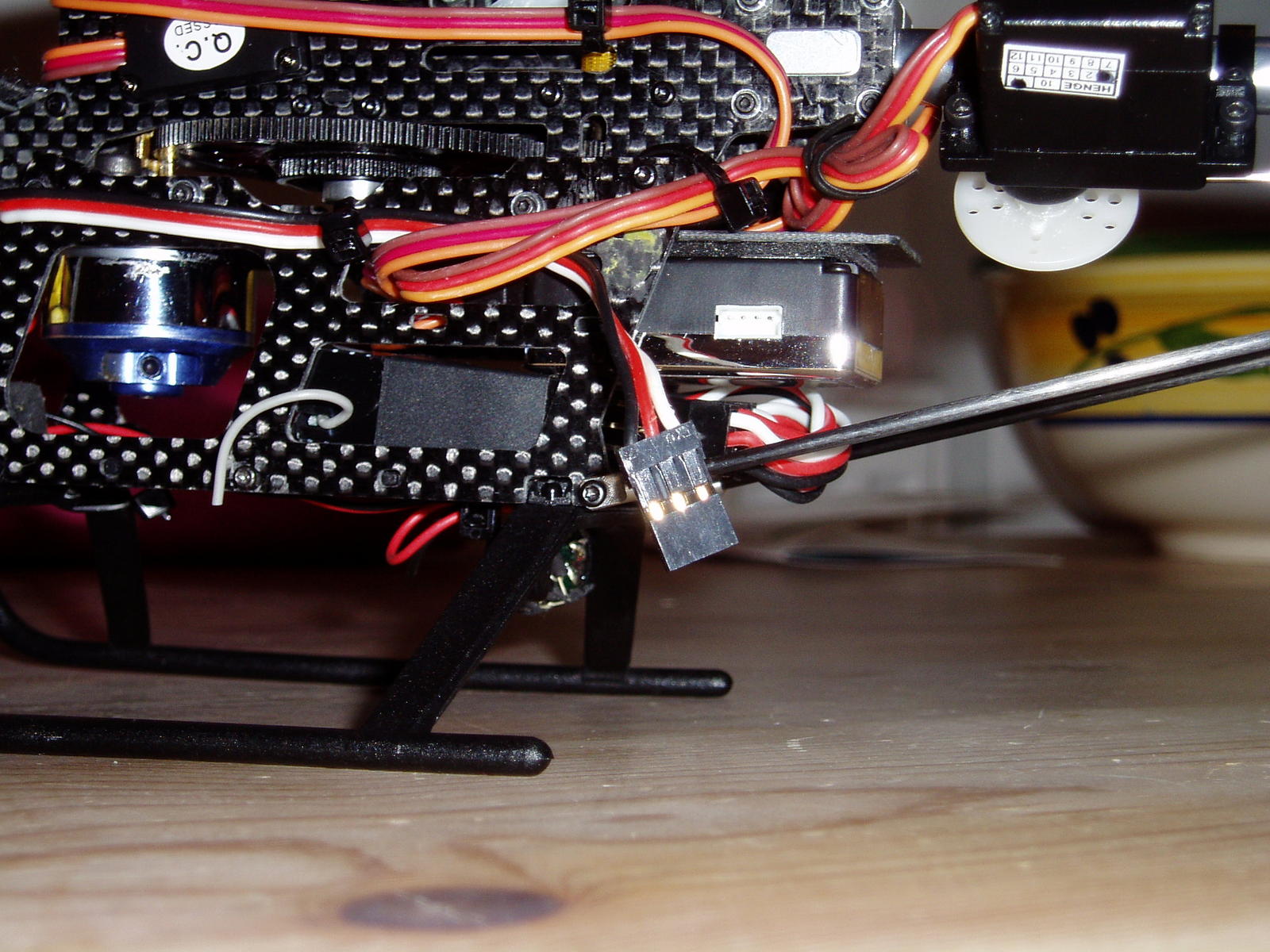

      Here is mine
      Gyro tray at top, ZYX taped underneath that, AR6100 on bottom plate, it's tight but do-able

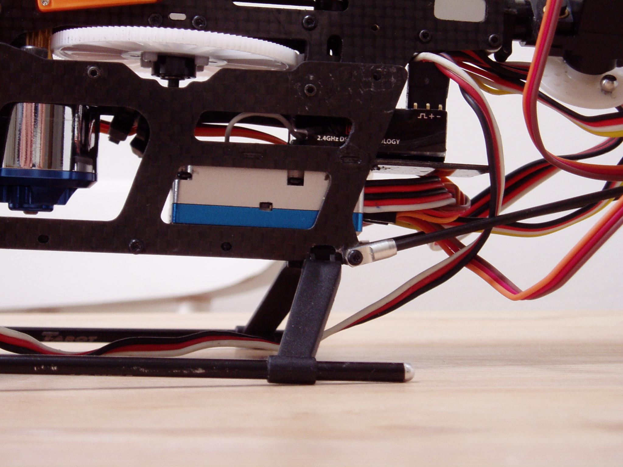

            Here's another option - this is going to be TT soon ...
            Gyro tray in middle - 3X1000 is upside down
