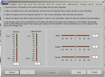

    For those with the above FBL unit and using the USB cable to set your parameters, do I really need to go thru the first page (using JohnNZ software: fbl.net.nz) of centering my trims and full throws using subtrims on my tx?
    The reason I'm asking is because 0 trim on my tx is not 0 trim on the unit. So do i follow the unit and adjust accordingly or ignore it and rely on my transmitter's center trim and full throws?
    I would and also I would use the Tarot software which is at version 2.5 (firmware update also) the last time I looked

        I would also recommend following these setup instructions Tarot ZYX - setup with program box
