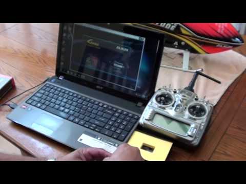

          According to the Align video you have to connect with USB to your PC to do the bind:

              I have 5 heli's with Gpro & still can't always bind first time around, you won't have a led until you've done the bind so as mentioned always best to use the usb first then once you've done the bind you can use the Bluetooth.

                            When you connect the Gpro to the PC with the USB cable and then power it up does the software change and show connected?
                            if so we know the Gpro is not dead and power source is correct.
                            are you using dsm2 or dsmx sats?

                              Did you try connecting your other Gpro to the PC software. When you run the program it will say 'Searching'. Then when you power up the Gpro it should say connected. You need to do this to set the receiver type initially. If one Gpro connects to the software and the other doesn't then you've got a dead Gpro. If neither connect then it could be USB cable or incorrect power supply to the Gpro's.
