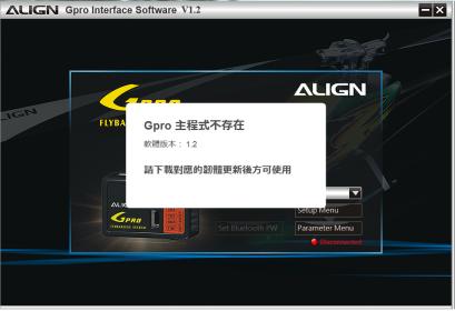

    i've just connect to pc & cant make the connection then tried bluetooth module it flashes but wont connect so unless im overlooking something sounds faulty Gpro
    This also appears when i connect to pc but cant read it
